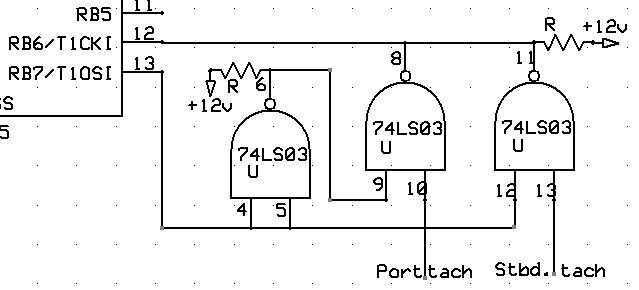

I couldn’t use CCP because timer1 is busy being a very stable frequency counter for a dual tachometer. (2 engines) I will pull out the stops on the servo for continuous rotation. It will have a tiny model boat propeller on it, mounted inside a gauge to indicate synchronization. It will rotate at varying speeds to indicate which engine is slower and by how much. When the prop stops, it is in sync.
[/CODE]
It's called a "synchroscope" in full-scale, twin-engine aircraft. Please let us know how it works. John
From a post here on Oct 3 2006
My best customer wants an indicator to help manually synchronize the RPMs on his 2 boat engines. He has an airplane with a sync gauge that has a propeller that spins one way or the other and stops when the engines are in sync. He really likes that and I thought I could put it on his boat. I can’t seem to find it or any others online.
The Yanmar diesels put out a hall effect tach signal at about 200 pulses per rev from the flywheel ring gear.
That is the main reason I got started with PICs. While just trying to make a whirly gig, I now have a perfect dual digital tach on a 4 X 40 LCD with the difference in RPM, port or stbd. I almost had it working with a gear reduced motor, a DPDT relay and PWM at about 2 kHz but the output was messing up the tach input. This was just before they took the boats to the Bahamas for 2 months. I did manage make and install a 10 LED bar graph before they left. It serves the purpose for now and I told him the prop version was in progress. I learned a whole lot in the process and there is no way I could charge him for all the time spent so I told him “No charge. Merry Christmas”. Besides, a little Karma goes a long way. Now I am on vacation for 2 months. (hehehe)
Well, Timer 0 works extremely well as a frequency counter too. Actually, it works better because there's an anomoly when Timer 1 is used as a counter that throws away the first count. Anyway, that would free up Timer 1.
I can't quite figure out what you're doing from your brief description and code but I suspect you could reallocate PIC resources to come up with a simpler cleaner tighter solution than what you have now.
Good luck with your project.
Mike
Tell us how you're implementing the Timer 1 frequency counter? How long and how often are you counting the hall effect signal on each motor? How to you switch the T1CKI counter input pin between motors?
There is synchroscope and synchrophase as applied to aircraft. The former is to help the pilot ensure the props are at the same speed. The latter is to help get them in phase. It makes a big difference in vibration and sound levels when the props go into phase. Larger transport aircraft, like the DC6 and B29, had phasing for their four engines. Small light twins usually do not.
Anyway, based on what you are trying to do, maybe there is a different approach that might be easier. Starting with a Hall signal from each motor, why not simply compare phase? Say, the position of the falling edge from each. You could also pull an RPM measurement from the same signal, but that would not be what would drive your propellor indicator. John
That is what I wanted to do in the first place but couldn’t find enough info. A PLL almost looked like it would work but I’m not an analog guy and it wouldn’t come together for me.
I have a friend that repairs avionics. He helped some. I did find some really trick mechanisms that control RPM by varying the prop pitch instead of throttle.
The frequencies range from approx. 1400 Hz at 700 RPM to 8000 Hz at 4000 RPM so if I count pulses for half a second I get and actual RPM number but that takes a 16 bit counter. I started using timer0, incrementing the high byte in an interrupt from Nigel’s tutorials but it fluctuated by up to 15 on every reading. Timer1 working in the background, without interruptions was perfectly steady and all I had to is calibrate the read time with delays. If timer1 will keep counting during the PWM interrupts, it will be perfect and I will just recalibrate.
To switch inputs, I used a 74LS03 open collector NAND gate controlled by RB7 as a data selector as per diagram below. With open collector, I could tie two outputs together and either gate can pull the output low without fighting each other. I will build another one using a 74LS157 data selector from that batch of chips Philba gave me.
Will timer1 keep counting during the PWM interrupts ?
