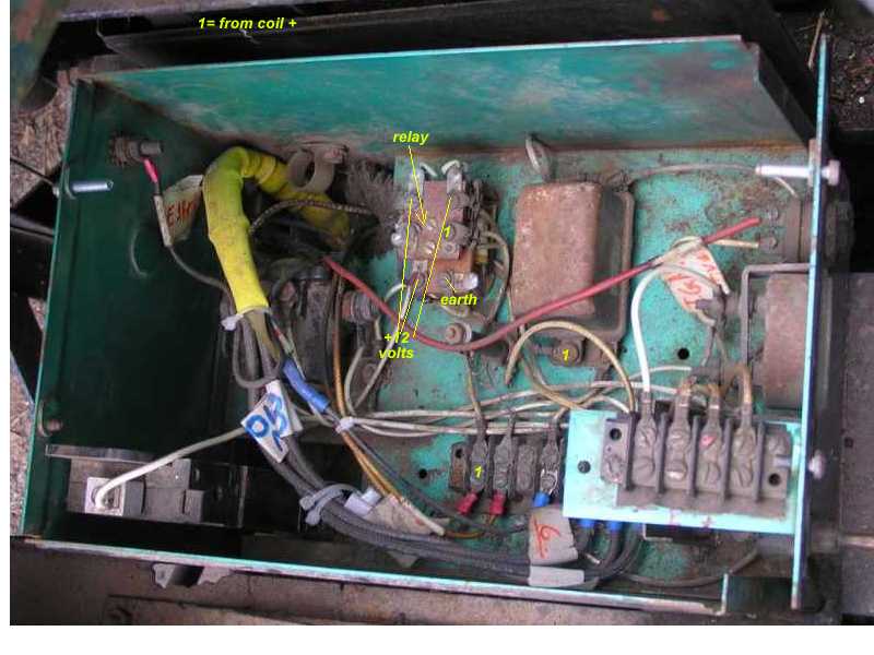

Hi Guys,
Well as WilliB said before a picture is worth a thousand words so instead of buyin a nu phone I went for a digi camera instead. So here's a pic of the electrical box. I've added a few details to the drawing and the voltages shown are on full time. I'm heading back to do a few more tracing and voltage tests so hopefully we can get ontop of it.
Cheers Bryan :D

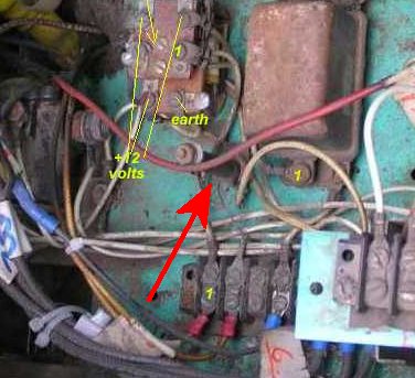

Hi bryan1,
This is the resistor that Nigel Goodwin mentioned in his post.
Hi Guys,
I didn't get much time to sort out the schematic today but I did get to show the picture to a couple of friends in the US, one of the blokes is an electrictian on the railways over there and seems to think the genset was originally 6 volts and after the alternator was reconditioned it was changed to 12 volts, thats one thought. Now the voltages I put on the drawing were taken without energising the system and when I did energise it it wouldn't crank. So I pushed on the front plate that holds the switch then it cranked, so the first thing I'll do in the morning is replace the switch. You never know it could simply be a shorted toggle switch. But with such an old model Onan motor another mate did say you just can't get spareparts for old Onan motors anymore as Cummins bought them out years ago. So this repair looks like turning into a major project namely replacing all the old electronics and modifying the motor to run on a more modern distributor where I can get replacement parts for. So as I say tomorrow I'll trace all the wiring and make up a schematic and make a start from there.
Thanks for all the advise so far guy's I really appreciate it
Cheers Bryan :D
