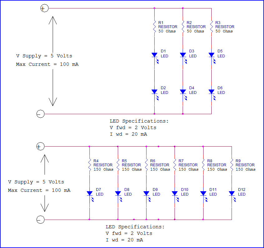

The trick with USB ports is not to overload a port.
Now here is the thing with LEDs. It becomes a matter of specifications. Yes, your LEDs are 2 volts and that is the forward voltage drop across the LED. Each LED also has a forward current that you don't mention. Believe me it is there. Understand that the lowly little LED is actually a current device. So if I have a 2 volt LED and I apply 2 volts to it the LED will draw its rated current and everything will be fine and wonderful. However, if I apply more than 2 volts to my LED it will draw more current in excess of its rated current and it will become very unhappy. Depending on the over voltage it can vary from a very short and bright life to a real quick blink ( a bright blink) and that is it.
Attached is an image of two circuits. Each is powered by 5 volts (V supply) with the supply limited to 100 mA just like a default USB current limit. One circuit will overload the USB port and one will not. Each circuit has 6 LEDs with their specifications provided. Each circuit had resistors in it to limit the current through the LEDs. You tell me? Which circuit will overload the port and why?

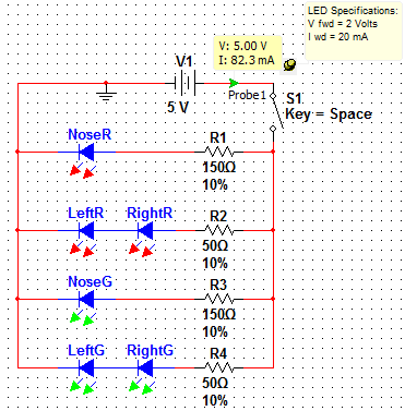

I'm currently doing my circuit and I will send it here so you can check if there is anything that make no sense.

There is my idea, if I put a timer or something to delay the light from turing on before each resistor will it take some mA? Also I dont want to have green and red led on at the same time, I want to turn the NoseR led off after like 2 sec and when off, turn on the NoseG and keep it on as long as the switch is close. For the LeftR and RightR I want to turn them off after 4 sec and then turn the LeftG and RightG on.
I dont know how or if my idea is possible to do using something simple and not too complicated so I dont need to go at university to complete it ;)
PS: Any idea how to know if I ever go over load on my usb port because I dont have any idea if the converter or simply the other 8 axis and button take allot or not.
I think the I: 82.3mA is generated by the program by considering a red led vf = 1.83V @ 20mA and the green led vf = 2.13V @ 20mA
Just to make sure you understand what will be activating the switch look at this: **broken link removed** That's what I'm doing and the switch for the led is the microswitch. Instead of using a battery I'm trying to use the usb port and my red light is for the first seconds when you lower the landing gear and the gear is not locked and then the green turn on and the pilot know that the gear is successfully locked.
Your circuit as drawn mimics mine as to Vfwd = 2 volts and I fwd = 20 mA. If that is true you have 4 legs and each is 20 mA so you have 4 * 20 mA = 80 mA.

Vsupply - V led / I led
So for a single LED it becomes 5 - 2 = 3 / .020 = 150 Ohms If you have 2 of the same LEDs in series then you add them so you would have 5 - 4 = 1 / .020 = 50 Ohms.
