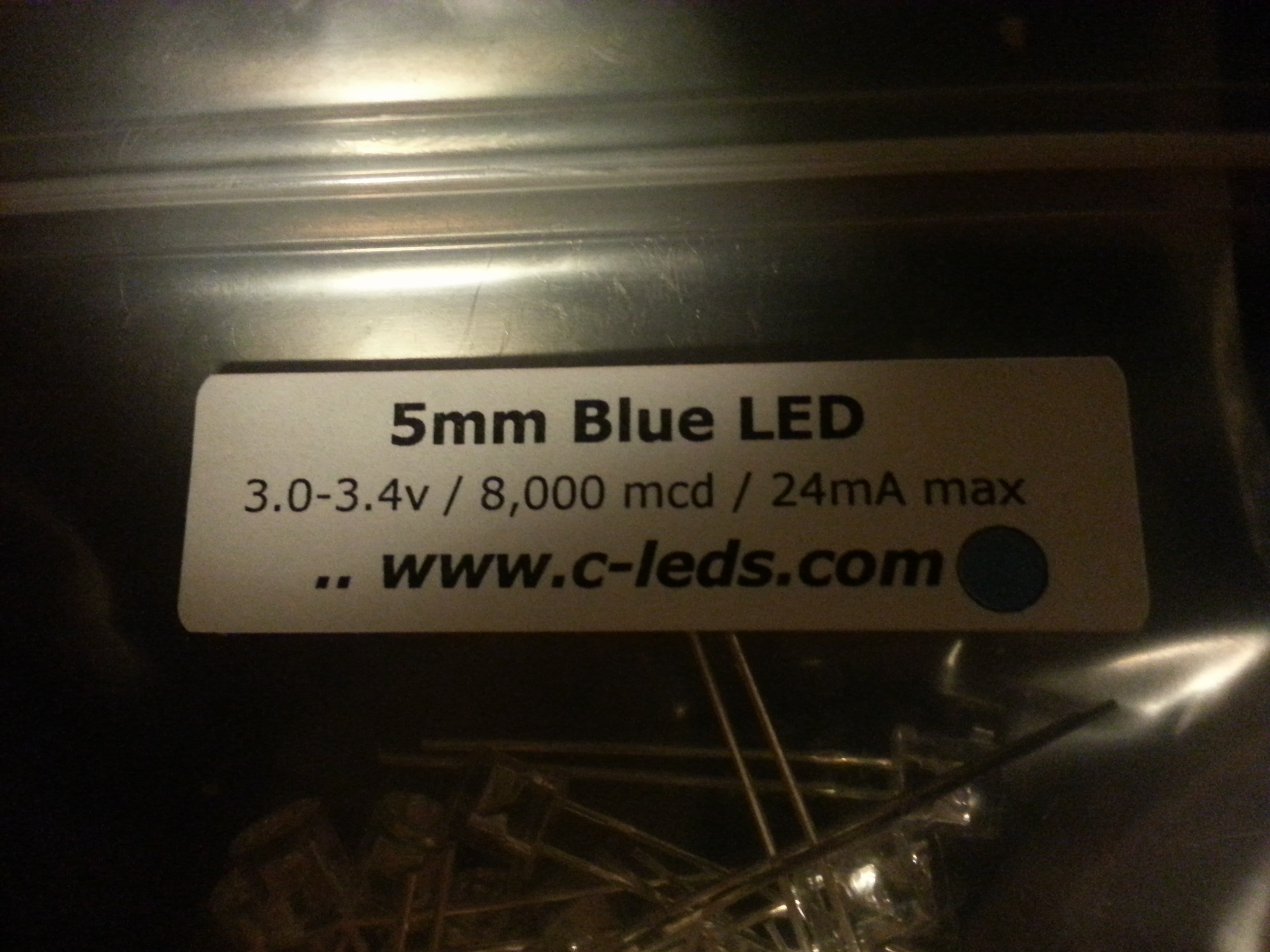

hello, I need help with what kind of resistors I need. I'm trying to string together multiple led's and I have no clue what to do :/ The led's specs are 3.0-3.4V/8000mcd/24mA max. they are 5mm wide angle blue leds. thanks!!!! 20130103_171644-1268376736.jpg
We need to know the voltage you are supplying to run the LEDs.
You might need to series parallel.
If you wire leds in series then multiply the voltage per led to get the supply volatge, 2 leds 6v, 3 leds 9v etc.
If your supply is 12v then run 3 leds in series, and then through a 120 ohm resistor, if you want more than 3 then multiply this arrangement, so 6 leds would be 3 in series with a 120 ohm, and then another 3 in series with another 120 ohm and so on.
I think we need to know the OP's actual requirements for the application first, given the quote:
"I'm trying to string together multiple led's and I have no clue what to do :/ "
An illuminated wearable suit, powered by a 240V extension cable, is quite different from a case-mod or accent lighting powered by a 12v wall wart.
it's best to use the 3.4V figure per LED drop, since that's worse case and LEDs could drop that much...
Actually no. If you use the 3.4V figure and calculate the resistor to get exactly the maximum allowed current, then if you happen to get diodes that have Vf only 3.0V the current through those will be larger than the maximum current you aimed for. And that is not very good for long term reliability.
For example with a 6V supply the current would jump from 24mA to 27.7mA.
that's why you don't design for the exactly maximum current... but if you only use 3v, then when you do your calculations and get LEDs with 3.4V drop, you don't have enough current, and can overstack and not have enough voltage to even turn them on....
Another reason you don't design for exact maximum current, not at 25°C, is what about temperature drift? you should only design for 80% of max current, using max voltage varying under temperature deviations. That gives an 8% cushion for temperature variation and 12% cushion for voltage variation. If a LED has a max current rating of 24mA, and you design to put 24mA through it, it's not going to have long term reliability, or any other part, for that matter.
