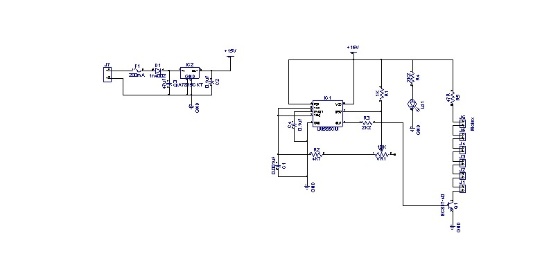

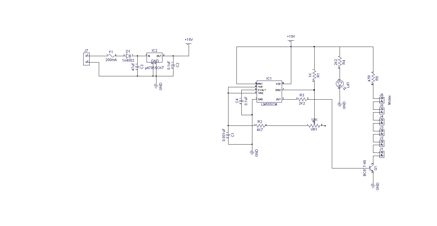

I had a circuit that powered some IR leds directly, but redesigned it with the O/P (pin 3) going into the base of an npn transistor, via a 2k2 resistor. For some reason, the frequency 'dissapears' on the base end of the 2k2.. Any Ideas?

We aren't psychic.....can you post a schematic!:D
Oops :eek:
I hope this has attached, and is readable
Jim :)

there? yes
readable? no
aha try making it a bit bigger
-MoRoH
The transistor will also saturate if you use 6.8K for a base resistor. May be that helps.
The "CV" input only requires 10nF.

Do you understand that the base voltage will only be ≈0.7V peak-to-peak?
Thanks Boncuck, do you think a 2K2 is providing too much base current?
Most of the other designs I have seen, you an even smaller value.
I've got 0.5v across base and emitter Ron
Jim
Jim
Are you checking this with a scope? I think going larger on the base resistor may be the wrong way to go, you are trying to drive a whole bunch of IR devices.
Your meter probably will not do the trick. If I get your circuit, your trying to drive a bunch of IR leds off the collector circuit. Just as a test, try using a couple regular visable leds on say two jumper blocks, short out the remainder jumpers and see if that works, ie leds should light up. I could not read the part number of the transistor on your schematic so I hvae no idea of its beta.
Its fixed :D
The circuit works OK, the problem was in the batch of IR leds. The leads were cropped the wrong way round! (long lead on the cathode side)
