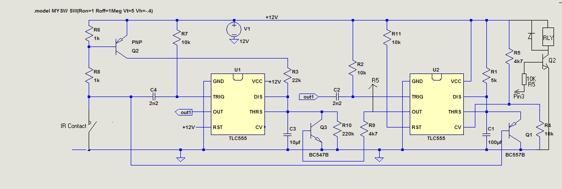

hi Theunis,
Since the earlier posts I did some simulation circuits.
Its has to be triggered for a minimum period or number of short periods.
Look at this example.
Eric
Thanks, again much more than I expected.
Please confirm components:
Q2 = BC557
V1= ?
V3= ?
I take it Pin3 of U1 goes to Pin2 of U2.
Can you give me a short explanation of the output ?
Again KISS please.
Thanks for the help.
Theunis

Q2=BC557
V1 represents your existing 12V supply.
V3 is there for the simulation only, it closes the MWSWitch contacts.
U1/3 >>> U2/2 [trig].
BTW: the U2/3 goes to your relay transistor driver as previously.

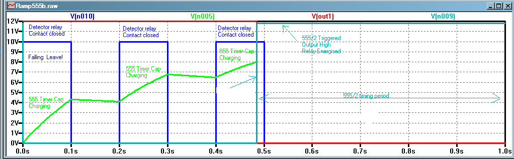

I'll post a plot of the waveforms, with an explanation.
The BLUE trace represents the relay contact closures of the detector relay.
I have shown 3 short pulses, that could be caused by leaves or birds breaking the beam.
You can see, during each pulse the timing capacitor of 555/1 charges a little, on the 3rd pulse the cap voltage is sufficient to allow 555/1 to time out.
The low going output pulse of 555/1 triggers the 555/2 input, as the 555/2 is configured as a mono its output will go high for the time of Res/Cap values.
In the case where the beam is broken for a longer period, the 555/1 cap will charge faster and trigger the 555/2.
When the 555/2 is timing it discharges the timing cap of 555/1, getting ready for any further beam breaks.
If the 555/1 see's say, just one leaf, then the charge on the 555/1 timing cap will be slowly discharged by the resistor in parallel with transistor.
You may have to adjust the timing values on the 555/1 to suit the application.
Do you follow OK.?:)

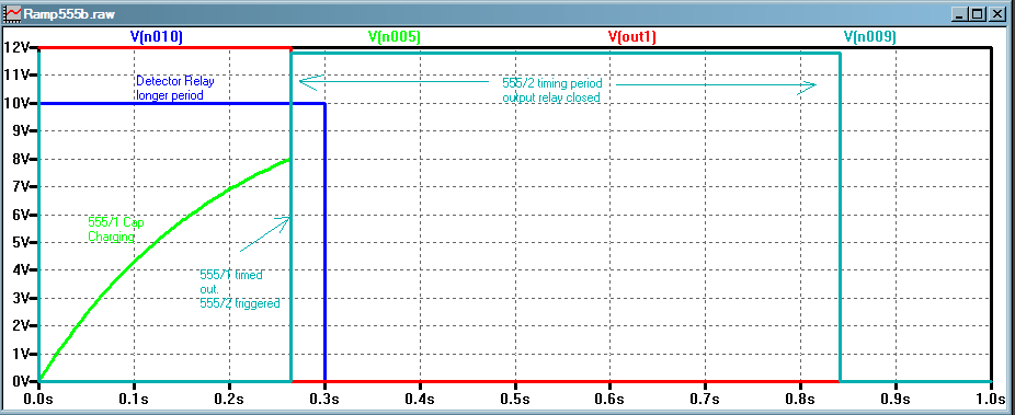

added a second waveform, showing when detector relay is closed by intruder.
Longer closure time.

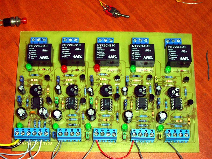

Attached is a photo of the main board that I have already built with 5 x 555 timers as per attached circuit at post #9 of this thread. (I have omitted the leds + their res, the jumpers with additional caps and resistor for a wider timing from the posted circuit for simplicity)
The idea is to get
Timmer #1 will switch a buzzer for X sec.
Timmer #2 will switch on outside light at night for Y min, at the same time as #1.
Timmer #3 will switch on a siren when set, and will be used as a panic button connected to a wireless remote button.
Is it possible and how to incorporate your trigger circuit with this main board circuit.? As posted in #9.
Otherwise I can rebuild it on your design, it needs to be a stable/flawless system though.
Im not sure what #9 means.???

Sorry I meant post #9
Looking at the circuit you posted, I would then only use U1, taking its output (pin3) to the trigger on my main board (J2) ? ? ? , (as posted in post #9.)
Which of the components can be omitted in your circuit if only U1 is used ?
(I just realize now you would probably have chosen a PIC with much less components to do the same thing ?)
Theunis

I thought we were trying to modify a one off, existing detector/555 relay driver.??? from being triggered by a falling leaf.
The rightside 555 is your original circuit with a leftside 555 delayed trigger added.
I havn't shown the output relay thats all.

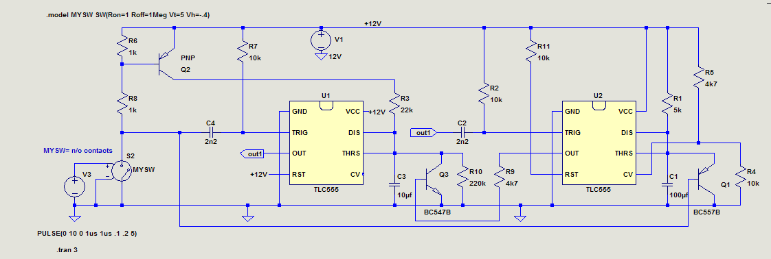

Sorry (My bad, you lost me.)
Yes, we are still working on the falling leave delay trigger to a 555 circuit (existing), (would it matter if there are 5 x 555 in stead of 1x 555 using the same delayed trigger from the IR-beam.) ?
Take it then that S2 is the trigger in, coming from the IR-beam ?
Can you indicate the output relay as well, can help to get mind around it.
What software do you use to simulate the circuit ?
Theunis
Look at this edited dwg showing the existing relay and the S2 relay contact.
Sim is LTSpice.
The 5 * 555 trig should be OK.
