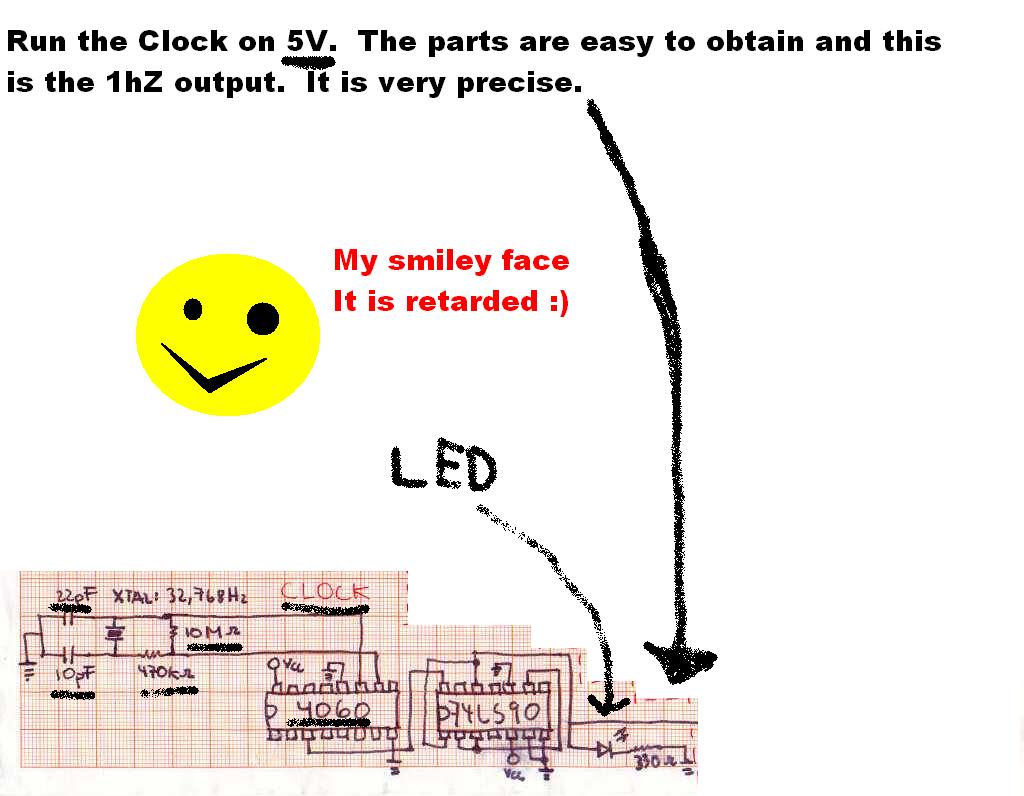

I reccomend a 1Hz circuit using a 32khz crystal. Search in the search box for
Digital clock, and find teh post by me. In the schematic it has a clock portion for a very precise clock circuit. But if you want to use a 555 timer use a 10uf cap across pin 1 and 2 and 10k ohm and 100k ohm across pin 8-7 and 7-6. Keep mixin up the resistor locations until you find teh right spot.

Yeah, I dont doubt the obvious superiorty of a Microcontroller, but that is overkill! All he needs is a simple little circuit! I would like to get more people into electronics, but diving them headfirst into PICs and Microcontrollers can overwhelm them (like me). If he knows programming and PIC, folo 3v0s links. If you want a simple 555 timing circuit, play around with the 555 timer until you get what you want. You may also want to try a 2 inverter oscilliator. Google them. Its really easy to make one. Just keep trying and looking at your options.
Man 3v0 Your never going to find a nice signature :D
You can also get perfect 50-50 squarewaves by sticking a divider on the output, although it's probably better to use a CD4060 and do away with the 555.

Here is the Clock circuit
That's a bit complicated for a 1Hz clock isn't it?

Lol no...
Mine has pretty colors and a smiley face so eat it! :)

Why use an old 5V TTL divide by 10 IC?
Use a 4017 or half of a 4518 Cmos IC that work fine with a supply from 3V to 18V. With a 9V battery then a current-limiting resistor is not needed for the LED.
