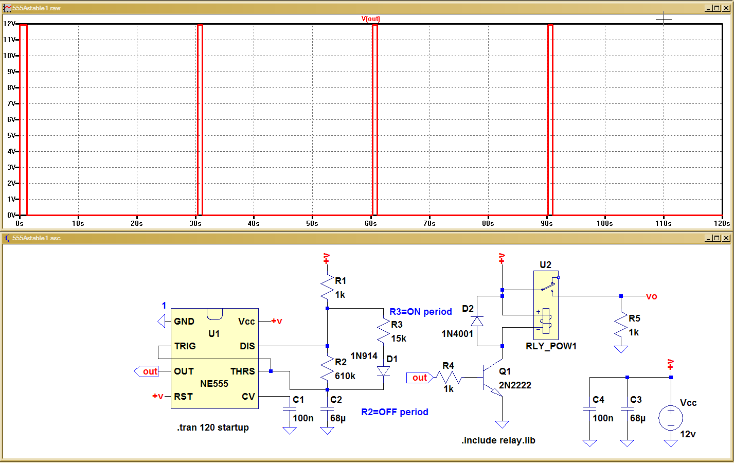

Can someone please help with a problem.
I can just about build a 555 circuit but what I'm after is something simple what will give a short on period and a long off period. I have look on the site and unless i have missed it can find anything.
I want to replace a manually operated switch with a relay (operated by a timing device), with
an on time of about a second with an off time of (around) 30 seconds
Any simple ideas for a novice ?

The easiest way would a 555 timer set as an Astable. Do you want the output to drive a relay.?? What is your supply voltage ??

Yes I would like the output to drive a relay / supply voltage is 12.43v
Just ideas of which components to change "UNLESS" it gets complicated than I would ask for a circuit diagram
The on period needs to be about a second (like you or me pressing a touch to make switch but the off period could b anywhere between 20 to 40 seconds

hi Steve,
I didn't post the drawing as it was a repetitive circuit, here you go...
BTW: The relay contacts have been linked to +12V for test ONLY.

Can you tell me what the R5 tie down resister is for
what ".trans 120 startup" under the 555 is?

can you give me an idea of what the off period is using the components that are show or is it trial an error for me to find of

You can use one of the many online 555 timer calculators.

Steve,
The trans startup is for my Simulator,,, the R5 as I said in my earlier post is for testing in my Sim....OK?

Eric can you please tell me what the components in the bottom right hand corner are for

The 12V is your power supply and the two capacitors are required to filter the 12V supply to the project.

Have been to maplins (usless bunch OPPS) and they dont have 2n2222 in stock so can i replace it with something else, I do have quite a collection so i may have it here in the house LOL

Ref the 2N2222, any 200mA, 24Vce, npn should be OK

Many thanks for the help "seriously you have helped loads" cheers but on the point of transistors and if i read it right would a 2n3053 be ok
The way I read it is ,, Vce 40Vdc & 700mA but will a 555 trigger the 2n3053
In your diagram c2 & c3 are 68uF ,, can you please offer a replacement as I have looked on maplins & ESR web sites and they dont list a 68uF elec CAP
There is 47 & 100uF , which would be best?
