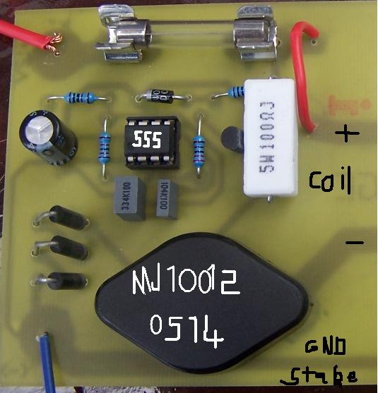

i have a kit from jaycar, it's called the jacobs ladder kit, but i can't get the arc to climb the ladder. i feel that the frequency is wrong. i heard somewhere that if you change the resistance between pins 7 and 8, it will change the frequency? also if there are some caps in the 7 and 8 pin circuit, what do they do?

what does it mean if there are some capacitors between the pins? here is a pic of the circuit. new.JPG
The capacitor at pin 2 & 6 to ground, R1 and R2 determine the oscillation frequency, as mentioned by Gayan. If there is a capacitor from pin 5 to ground, it is used to bypass the noise of the supply. It doesn't affect the oscillation frequency.
