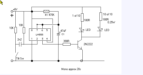

Hi, I need some help with a side project I have going on. I have an extremely limited knowledge of electronics, so please excuse the lack of the schematics or incorrect terminology.
The objective is to make a small light that is activated by motion and will remain on for 20 seconds and then deactivate. i.e.you pick up the light it illuminates you put it back down and it remains on for 20 seconds then turns itself off...until it is picked up again.

Due to the fact that the power is 4 * 1.5V = 6V [ with fresh batteries] each 3.2Vdp LED will require its own series resistor.
Allow say 15mA/led from a 6V supply so, Rseries = [6V - 3.3V led]/0.015 = 180R.
Say 15mA/led, 10 * 0.015A = 150mA.
This means when using a CMOS 555 the 10 LEDs will need to be driven by a transistor, which in turn is controlled by the 555 timer.
A 2N2222 transistor would be OK.
Configure the 555 as a Monostable with a 20sec period.
Use the tilt switch to trigger the 555 input.
Position the tilt switch so that it is normally open in the 'resting' position.
Do you follow OK.?:)

I will admit this bit has confused me, will I need a resistor for each LED or 1 resistor for each series of LEDs?
With regards to the math,am I correct in thinking that Rseries is the calculation for the resistor required = (power voltage - forward voltage) divided by the mA drawn. By your calculation this is 180R. Is R equal to ohms?
How do I decide what size resistor is required, 1/4w or 1/2w? Would this make any difference?
Ive seen a few schematics of these.
After some hunting I think this is the one I need, is this correct?
Am I correct in thinking Q1 is the transistor and C1 is a capicitor? How do I calculate the capicitor size, if need one?
I also dont understand how the time is controlled. What is the difference between a 20 second timer compared to a 10 second timer? How is it altered?
Finaly as a true display of my lack of knowledge where do the LEDs fit within the circuit if this circuit is indeed the correct one?:eek:

Have a look at this circuit.
To increase the timing period, increase the 470K to 1M0 or the 47uF to 100uF.

I can understand the circuit you've uploaded and feel capable of assembling it ... except for one little details:eek:; coming off the 1 & 2 leg is a capacitor labelled 2n2, what does this mean?
I was also thinking it would be a good idea to insert an on/off switch so the circuit can be disabled during transport, would it be acceptable to just put a switch coming off the battery terminal to break the circuit?

The 2n2 is a 2200pico-farad capacitor. [2.2 nano-farad]
Fit an On/off switch in the +V line of the battery.

A big thanks to you all especially Eric.
I have now built the circuit and it works exactly how it is supposed to.
It is fanatactic and worth the effort(I may try my hand at some electronics in the future:rolleyes:), thanks for the time you put into helping me with this project:)
