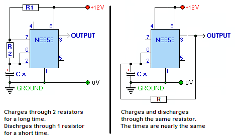

Hi im trying to work out how to get a 1 second square wave from a 555, im not to sure how to obtain this wave.
I want the output to be High for 1 second and then low for 1 second and so on, i have searched google, but cant find anything i can fully understand.

I went and searched google to try and find how to get a 1second square wave using a 555, well i found many sites describing how to get the square wave, but not the times that i want,
i have looked at the formulars, and i can work out how to get the high pulse but not the low, meaning i know the total resistance of both resistors to obtain 1second high, but dont know how to split the resistance to get the 1second low? eg:
t1(High) = .693 X (R1+R2) X C. dont know resistance?
t2(low) = .693 x R2 x C dont know resistance?
i can work out the total resistace for t1(high) by doing this equation
100(1second) / 0.000470(capacitor) = 212765.957 / .693 = 307021 ohms
so 307K is the R1+R2 total using a 470uF cap, im probly going about this all wrong,but i cant find how to work it out????????
I want to use the high/low times to find the resistors,not the resistors to find the high/low times?

Your 555 circuit has different charge and discharge times so the output is not a square-wave.
You can bypass one resistor with a diode so that charge and discharge times are the same or you can change the circuit slightly like this:
i went with the bypass over R2 (R1 and R2 are of equel value) with a diode and got an even high/low,thanks!!!
so if i want 1second high and 1second low would the formula go like this
2(2seconds in total) divided by 0.000470uF(cap) = 4255.31915
and then
4255.31915 divded by 0.693 = 6140ohms total (for both resistors)
so i half that so its 3070ohms each (R1 & R2) equaling 1second high and 1second low??? i dont currently have these resistors to check if im right

The traditional way a 555 is wired to generate a 50% duty cycle is given in the datasheet, page 10, including formulas for both high and low times:
https://www.electro-tech-online.com/custompdfs/2007/12/LM555.pdf
EDIT: If you don't want to do much math, just figure out the ON time with the standard equation: t1 = 0.693 Ra C, which gives 31k for 1s. According to the datasheet, Rb cannot be greater than 1/2 Ra in this mode, so stick a 20k trimpot in place of Rb, and crank it until you get your 50% duty cycle. Then replace the trimmer with the respective value.
Or, do the math :)

Audioguru, I have not seen that circuit with pin 7 (discharge) left open before. How close to 50% duty cycle does it give? John
I never made the circuit but it is close to 50-50.
The trigger threshold for pin 2 is 33.3% of the supply voltage and for pin 6 it is 66.6%. But the output sinks 0.01V to 2.5V from ground and sources 1.3V to 2.5V from the positive supply depending on the amount of load current. It is best with a huge hot 200mA load.
Thanks. I have always used the diode to give easily controlled duty cycles. I will have to try that alternative some day. John

The 555 timer has always been an interesting IC for me. I had not seen the particular data sheet by National so I did the math with the components shown for figure 14. I came up with about a 6% time difference between
t1 and t2 with Ra 51K, Rb 22K, and C .01uF. I then built the circuit and looking close on the scope I could see a slight time difference between t1 and t2. I then measured the frequency on my counter and the frequency was 1.398KHZ. I then used the 51K and the .01uF and built the circuit posted by Audioguru with the charging and discharging path from pin 3 of the timer. There was no load on the timer as suggested by Audioguru, and there was a clearly noticable difference between t1 and t2 times. The frequency measured was 1.236KHZ. I then put a 1K pull-up resistor from pin 3 to Vcc.
The waveform had equal times for t1 and t2. The frequency measured as 1.357KHZ.
Looking in my copy of,"The 555 timer applications sourcebook",by Howard Berlin he recommends the pull up resistor from pin 3 to Vcc and the value should be at least 1/10 the value of the resistor from pin 3 to pins 2 and 6.

Well after alot of testing different ways of being able to do this, the best and most accurate way that i have found is what audioguru had suggested i do, and thats to add a diode across one of my resistors,
if i use two resistors of the same value, with a diode to bypass one resistor i get an even high/low output everytime.
so say i want 3.2seconds high and 3seconds low using a 470uF cap, i do this
3.2/0.000470 = 6930 then 6930/.693 = 10K resistor
so i use two 10K resistors(one with a diode) and i get 3.2seconds high and 3.2seconds low, and its very accurate.
saves the hastle of having to work out the other resistor thats needed if i just use two the same!!!
