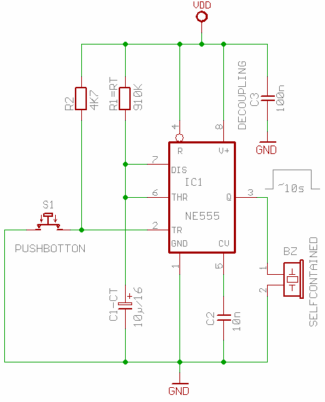

Hey gang! I'm working on a prop for an airsoft scenario and I have a question.
A while back I purchased the timer kit from **broken link removed**. What I'm wanting to do is hook it up to a 10 second 555 one shot, which I've found schematics for and am confident I can make, to push a 120db siren so it can be heard from a distance. The problem, is when the alarm goes off it sends pulsed voltage to piezo buzzer and the voltage is incredibly low.
I did a little research and it looks like a monostable multivibrator will allow me to take the low, pulsing voltage and make it steady voltage and step it up enough to activate the one shot.
So I guess the question is; am I on the right path?
TIA

Hi mainframe,
you see me confused as well.
I don't understand what you are getting at.
Here is a classic monostable made with an NE555.
R1 is the timing resistor, C1 timing capacitor, R2 is a pullup resistor for the trigger input to have a defined high level if not triggered. C3 is a decoupling capacitor. BZ must be a selfcontained buzzer (with internal sound generator).
VDD might be between 6 and 15V.
Boncuk

Kind of !!
First - what signal is going to activate the timer ?
A monostable 555 will produce a single high pulse for nn seconds -
An astable 555 with produce a continuous stream of high and low pulses.
Unsure what you created to produce a 10 second burst of pulses - was it 2 timers connected together ?
The 555s output cababilities are limited in terms of voltage and current - so we need to know the maximum current and voltage of the siren you intend to use - it may need an extra transistor or little relay to drive it.
Can you post a diagram of what you built so far..

So I built the one Boncuk showed with a couple exceptions. I changed R1 to 470KΩ resistor to shorten the time and the 555's I have on hand are TLC555. The pinout is arranged different but the pins are the same.
Here's what I'm getting. When I close the "button" side of the circuit and release it my siren clicks and in about 6 seconds it clicks again. So the timing is acceptable. But, if I keep the button closed I don't get the second click from the siren until after I release. I checked the voltage, and I'm getting just under 2v from pin 3 to ground so I can't try to work my 5v relay in there.

Hi mainframe,
you're obviously using a sound transducer instead of a selfcontained buzzer.
Just for your information: A selfcontained buzzer generates an audible signal when connected to a DC power source.
If you use a sound transducer you'll have to make the sound signal yourself, which you can do using a dual timer chip, one wired as monostable and the other as astable multivibrator.
The monostable will trigger the astable (set to the desired audio frequency) to have the piezo transducer sound at your desired frequency and time.
The monostable I suggested is a retriggerable one, meaning it will keep the output high as long as the button is depressed + time delay set by the timing RC combination.

The siren is self contained. It the picture in the forum I linked to the motion sensor trips the relay allowing the 6v from the lantern battery to flow freely to the siren. It screams like a banshee.
I think the problem is that the 2 volts coming from pin 3 isn't high enough to hit the low threshold on the siren which is rated for 6-14v.
If my understanding about transistors is correct, I can run undiluted voltage through it to the siren and use the 2v from the output pin to activate it. Am I right with that assumption? And if so once the voltage from the output drops out will current through the transistor stop? Would I use a NPN or PNP transistor for this effect?
