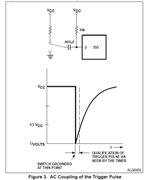

Hello all, On a 555 one shot, I understand it only takes a pulse to trigger the "timing" sequence. What happens if the trigger is held down for a long time? Will the circuit reset it's self and cycle again?

As for the 555, information about triggering is in most of the datasheets, but there is an application note from Philips that I usually go to, because it is easy reading. It also has a few little tidbits that are not in many datasheets. The note is AN170, but last time I checked, Philips had taken it down from its site. I uploaded it to ETO here: https://www.electro-tech-online.com/attachments/555an-pdf.52952/
If you are still concerned about continuous triggering, then you can AC couple your trigger as shown in Figure 3 of that note:

Pin 4 is "reset." It is usually held high; although, some retriggerable designs use it. This is where posting a schematic becomes really important. Once you get something bread boarded, please post it.

The thing I was afraid of was having the starter motor engage after the engine has already started running.
Presumably you will also want to switch off the power to the starter motor immediately the engine gets running? Or are you going to keep it powered for a fixed time (set by the monostable) regardless of whether the engine is running or not, and rely on the Bendix over-run?

Yes, I think 5hp although an ambitious undertaking can be had. ....with allot of heat. As for the circuit, I built a monostable as per Tony Vanroon's tutorial to see if it would work and it did but the led on the breadboard only timed out once I dis connected the trigger from ground. And yeah you were rite, Pin 2. :) I'm thinking of ways to over come this, and re checking the circuit for any mistake I might have made.
Here's the circuit I just tested:
This circuit is on his web site.
Hi, what I'm thinking is to engage the motor for just one second and rely on the over run. Stirlings take a couple of minutes to reach full speed so I thing it will work. If not, than I'll have to beat my head into the possibility of using a hall sensor or something similar to "let the starter circuit know it's running". The challenge I've created for my self now is how to send just a pulse from the thermostat instead of a steady voltage....

I built the circuit on the left at first, but the one on the rite is what I wanted. Every time I grounded the 0.1 uf capacitor, my led turned on and off for the same duration weather I disconnected the wire or not. I then used my thermostat as my switch (nte-dtc180) and held a lighter near it until it triggered. Putting a larger capacitor from pins 6 and 7 to ground increased the time the led (in leu of the relay) was on. So now its just a matter of deciding what size capacitor to use in my circuit. That will depend on how the engine turns out. but now I know how to start it and never have to touch it!
More to come, Thanks!
Note, The circuit came from the link above for any one who wants an explanation of the difference.:)
