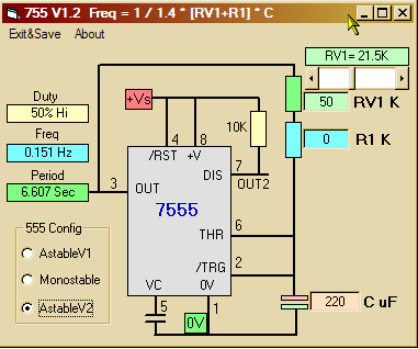

I'm working on putting a multivibrator circuit together that will have varying output frequencies based on several DIP switches that select several resistors to be in series. I am using this circuit: **broken link removed** with C1=1µF and an LED from the output to ground. I am trying to get the off- and on-times to be equal, so my understanding is that R1 would be 0Ω and I just need to vary R2 (in my case, R2 varies from 100Ω to 26.5kΩ).
However, when I hooked everything up, the LED would be on for the on-time, but would then remain off. Each time I turned the circuit on this happened. I eventually tried placing a 360Ω resistor in for R1 and suddenly my LED would flash. I tried lower resistances but that produced the same results as before. Also, when I replaced my R2 with a 10MΩ resistor and used R1=360Ω, the LED just stayed on and never turned off.
Does anyone have any suggestions about what could be happening?

Thanks for the suggestion. I ended up figuring it out this morning. I tried several resistor values for R1, and the lowest that I had on hand that would allow the circuit to function was a 220Ω. Using this resistor still gets me to a 51% duty cycle when my R2 is at 5.1k, so it's close enough for government work. I also found my error with the 10MΩ as I just had it hooked up incorrectly.
