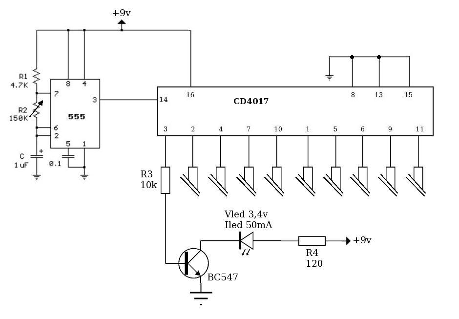

I've realized the circuit as scheme attached.
When the output pin is high the BC547 drive led properly.
When the output pin is down I've a constant bright light on led.
Why?
I've also put a 1N4148 in series to led but... nothing.
Any help?

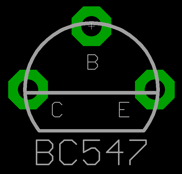

You are sure the leads of the BC547 are correct in accordance with the data sheet.
Ron
BC547 top view.

Yes, the load are correct like scheme attached
COLLECTOR connected to led, resistance, +Alim 9V
BASE input ipmuls from CD4017
EMITTER gnd
I continue with the verification.

Yes, I've got impulse out from CD4017. If a led is connected in every leads, I've got the right, unique flash when the pin goes up.
Only when I connect a BC547 (like the scheme show) to drive a HB led I've:
OUTPUT DOWN - feeble light on led
OUTPUT UP - high bright light on led

I think we have another symptom here of using a breadboard:
1) Output of CD4017 goes low which makes the base current in the transistor zero.
2) With a base current of zero then the collector current of the transistor is also zero.
3) But the long wires on the breadboard are acting like antennas for all the radio and TV stations in town (and all the cell phones) and feebly lights the LEDs.
Try connecting a 3.3k resistor in parallel with each LED to fix it.

The 555 in your circuit creates 400mA supply current spikes that cause the 9V from the battery to momentarily collapse each time the output changes.
Datasheets for the 555 say that supply bypass capacitors are required to prevent the collapse.
Try connecting a 100uF capacitor in parallel with the battery.
Maybe the feebly blinking LED is picking up radiation from the output of the 555 since it seems to blink at about 10 times the normal rate. Again it is caused by the long messy wiring of a breadboard.
Isn't the 555 on a different breadboard than the CD4017? Then the 400mA supply current spikes are causing a voltage drop in the wiring between the two which might cause the transistor to turn on each time the 555 changes.
If you use a Cmos 555 like an LMC555, TLC555 or ICM7555 then there will not be any supply current spikes.

I've made it all in one bb but also with the capacitor 100uF on principal main nothing new.
Okay, this should not be this hard. As a Sanity check do the following:
  • Disconnect R3 from CD4017 pin 3
  • Connect R3 to ground. (LED should go out)
  • Connect R3 to +9v (LED should light)
If this works, we need to look elsewhere. If it does not work, LED or transistor is hooked up incorrectly.

I've re-assembly all the circuit in 1 bb and checked and re-checked... all ok.
Is an error an circuit?
I've used NE555N and CD4017BCN
I've try to replace le hb led with another red standard and the feebly is not present (or I can't see it). Same result with another green standard.
But when I use hb white led with transparent lens (I've different type of them from 60mcd to 285mcd) the feebly is present between one and other flash.
