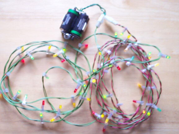

Over 10 years ago I built some small Christmas light strings. They were powered by a pair of C cells in series. All the LED's are in parallel and the only other components in the circuit is a on/off switch and a 3A schoky diode.
There are 53 LED's in the two strings. Current draw from the battery is 820Ma or 15Ma average current LED current.
During the same period of time I wired a horse(LIVE) with over 300 LED's for a night parade. I used 2 battery packs and the the LED's worked for a number of hours.
The Christmas lights still work to this day, and have been used almost every year since they were built.
