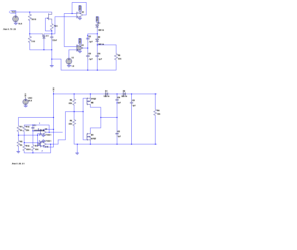

I'm looking into that idea, can you post your schematic? so I see what you did and maybe adapt it to my situations.
I'm thinking double the voltage and feed the gate via optic isolator or small FET. Without actually drawing, building and testing, my basic concern is the current draw created by the gate to source resistor, Would a DC to DC converter supply enough current at the higher voltage. The charge pump I'm looking at is Microchips TC7662A or B, <$2.00 @ Allied Electronics.

I did some simulating and since my circuit already has an oscillator, I figure I can use it to create my own voltage double. May need to use a P and an N FET to get load handling capabilities, but it's fun and interesting to try oddball things. Then I can use some optoisolators and separate my control circuit from my power FETs and use N FETs only. Thanks for sharing your ideas and giving me ideas about different ways to accomplish my goals.

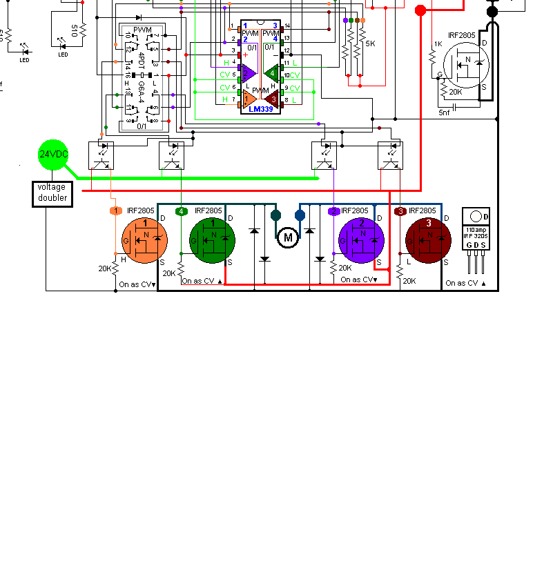

I know we hate secrets here, but I'm not quite ready to share the full schematic yet. I'm afraid someone steal it, improve it, and beat me to the use of it. I think it's called paranoid.;) POST.PNG
