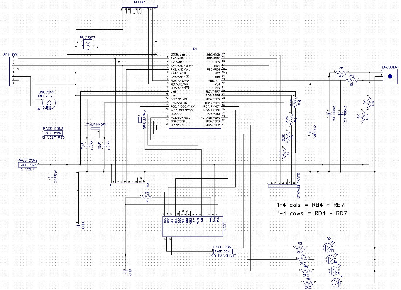

Hi All,
Like a lot of others I am new to this. I wanted to develop a function generator so I designed a development board with a number of external components including a 4x4 matrix keypad. It all electrically is connected correctly and in the program below the flashing LEDs work but I cannot get the 4x4 board to even light up a LED..
I have used the code from here as a start
https://www.qsl.net/pa3ckr/signalgenerator/keyb441.txt
I have attached both the schematic and the code I have been working on.
In the end I have set both RB4-7 to INPUTS and RD4-7 to INPUTS. [should they be both inputs???] I am not sure this is OK but it seems to work in MPLAB when using stimulus.
There are weak pullups on PORTB. I am not sure how this ties into the process but there is 5 volts on the each of the pins on the matrix board (EDIT 5 volts on RB4-7 and 1.48volts on pins RD4-7)...
I have no way of know if the 4X4 board is connected properly.
Anyway any help here would be greatly appreciated...
Simon schematic..jpgView attachment keypad..txt
RB4-7 should be input but RD4-7 should be output and initially set high. You then set 1 of the port pins low and read RB4-7 to read one column. You repeat this for each of the row pins to read the complete keypad. I don't have time now to look at the code but will look tomorrow if you are still stuck.

For the RB interrupt to work you need to make D4-7 zero so when a key is pressed it makes one of the PORT B pins go low.
Hi Mike,
Thanks for the reply.
I am getting this logic backwards I think... I thought I was setting RD4-7 high and with a key pressed this would send one of the RB4-7 pins high thus setting off an interrupt. How should this work? it seems I should have it about face with RB4-7 high with a weak pullup and RD4-7low.
If this is the case then how does the interupt work when the RB4-7 pins are already high?
Simon
Hi simon,
The port B change interrupt happens whenever B4-7 change. If you turn on the WPUs then port B will be high. If you make the port D pins low then when a key is pressed it will make one of the port B pins go low and trigger the interrupt. The interrupt will also happen when you release the key as the port B pin will go back to the high level.
