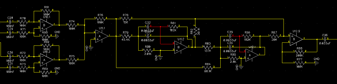

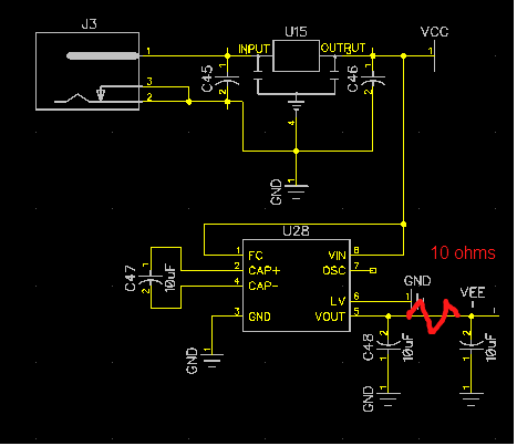

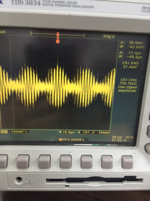

Looking for some advice on the forum again since I had really useful help the least time I posted. The scope picture (Picture 3) is at the output of Picture 1 on C36 with no input connected, inputs being C28 (Tx+) & C29 (Tx-) and also C30 (Rx+) & C31 (Rx-). This noise is present on the output and I can't seem to figure out what is causing it. Picture 2 is the power circuit, which takes +12VDC in and creates the +5V and -5V rails for the op-amps. The IC is a MAX660ESA (https://pdfserv.maximintegrated.com/en/ds/MAX660.pdf). I had managed to eliminate some noise on the rails by connected FC to VCC which switched the MAX660ESA to operate in 40KHz mode instead of 10KHz mode.
Also, FYI, the notch filter portion is not my design but it is a design taken from a working module so any ideas about what could be changed there would be appreciated because I honestly have a hard time wrapping my head around it.

Step one:
Remove +12V, and stop U2 from working. Power from a known good +/-5V supply.
OR
If this is too much work; stop U2 and power from +12V and a good -5V supply.
I want to know that the noise is (is not) coming from U2.
Step 2:
Look at the output of each op-amp. What ones are quite/ not quite.
On your last picture I see two frequencies. What are they?
Opamps do not need a negative supply if they are biased at about half the positive supply voltage. The Mickey Mouse switching negative voltage generator is causing the modulation (about 70kHz) and the 757kHz is one of the opamps oscillating.

So I removed the U2 and attached a -5V source and the noise was gone, so thanks ronsimpson. audioguru, I unfortunately do not have the luxury of redesigning this for my current run, I have to use these boards so using +12VDC and GND and biasing the op-amps isn't really an option. I'm wondering if there is anything I can do to reduce the oscillation on the switching supply or if there is a more suitable replacement?

Hi Bruce,
Now that the source of the problem has been identified you could try more decoupling on the - 5 volt rail and possibly the +12 volt rail. First I would suggest that with the negative rail still powered from the external -5 volts that you re connect the +12 volt to the MAX660. If the noise comes back then noise is being injected into the +12 rail by the MAX660. You could try adding a decoupling capacitor of about 100 nF right between ground pin and the 12 volt pins of the MAX660 and increasing the value of C46 If you post the results of these test myself or others will advise on the next step. Posting a picture of the copper side of the PCB with the ground tracks highlighted would also be helpful in case there are any sections of the track that both carry current to the MAX660 and analogue signals.

I must clarify though that the input to U15, (the +5VDC voltage regulator) is the +12VDC and the input to the negative voltage switching regulator is the +5VDC. For my test I left the +12VDC and the +5VDC in circuit and replaced the -5VDC regulator only. So I will try your test to check if the MAX660 is injecting noise into the +5VDC rail (sorry I should have clarified this better).

So it seems that with the MAX660 still on the board, except with the Vout pin lifted, and the -5V powered externally, the noise is still not present. So that means that the MAX660 is not injecting noise back into the +5V rail but only onto the -5V rail. With that discovery, I think I should focus on how I can best patch the MAX660 (drive with external crystal/decouple better?) OR change to another -5V regulator with a much higher frequency built-in oscillator.

Hi Bruce,
That's progress. First try adding a 100nF capacitor between pin 3 and pin 5 (Ground and -5 out.) of the MAX660 and increasing the value of C48. If that does not fix the problem then add a resistor of about 100 ohms in series with the -5 volts to the op amps and add another capacitor between ground and the op amp side of the resistor. Try about a 10 uF capacitor (and maybe a 100nF in parallel with it.) This is trying to filter the output noise from the MAX660. Check that the 100 ohm resistor does not drop the -5 volts too much. If that does not work then I have run out of suggestions for the moment.

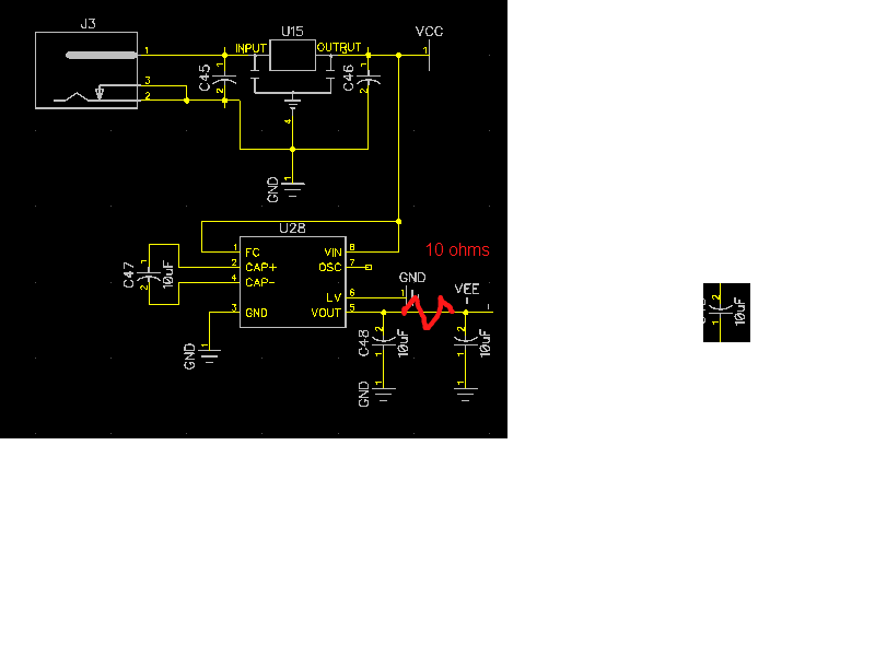

At U2 pin5 there is a cap to ground. Good.
You need to cut this and make a CRC filter. (so U2-5 and Cap is connected to VEE through a low pass filter)
I would add a 10 ohm resistor or something.
Sorry I can not draw a good resistor. LOL
The RC should be set to reduce the signal at the switching frequency.
A CLC filter would be better.
The value of R can be set so only 0.1 volts are lost across it.

Which opamps does the circuit use? Maybe their supply noise rejection is poor at the fairly high frequency of the charge pump.

ronsimpson thanks very much, I will see if putting in a simple filter does the trick tomorrow.
audioguru Here is the op-amp I used: https://www.ti.com/lit/gpn/lmc6482 Admittedly, I did the design in a high pressure situation so I sort of rushed it and I did not notice that section about the low ESR caps to reduce voltage ripple before. I may have to try that to see if it makes a big difference.

The opamps are fairly slow but still have a power supply rejection of more than 100 times at the frequency of the negative voltage generator.
I think the output cap of the negative voltage generator does not filter its noises properly.
The very high frequency might be caused by positive feedback caused by adjacent coupling on your pcb.
Thanks audioguru, this is similar to your first comment about the two frequencies observes in the scope picture. From what I've understood from yours and ronsimpson's suggestions, I need to filter the switching frequency from the negative voltage convertor. I will be back at it tomorrow morning and will post with results. I maybe close to a feasible solution to my issue....thanks again.

ronsimpson I tried putting in just a 1Ω resistor for an RC to make a cutoff frequency of ~14KHz but I did not change the two frequencies present at the output, which are 40KHz and 500KHz waveforms.
Tony Stewart I suppose I will try to change out the capacitor with a larger value and a lower ESR.
Since internal ESR is 10 Ohms max , adding 1 Ohm is insignificant.

I would expect a twin-T active notch to perform with a deeper notch and flatter passband.
