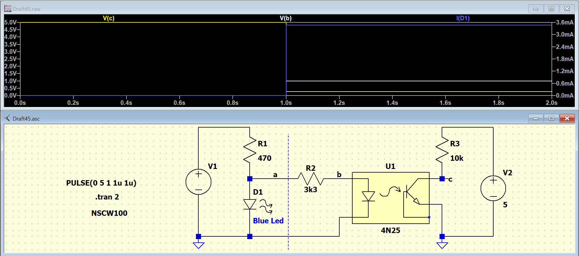

Hey all i am just wondering if my drawing below is correct in order to have an arduino detect an on or off led on another board using a optocoupler?
My thoughts of the above drawing is that when the led is on it will trigger the relay inside and send 5v to the arduino digital pin to read. 0v if the relay inside is not connected.
I also would possibly need to tell the arduino digital pin that its an input pullup like this:
pinMode(pin, INPUT_PULLUP);
please advise if this is correct or not.
It might work if you use the Opto coupler's transistor to pull the Arduino's input pin to ground. If the opto is off, the internal pull-up in the Arduino pulls the input pin high. If the opto is on, it sinks current, and pulls the input pin low.
You should use a separate current limiting resistor in case the LED in the opto has a higher on voltage than the one it's in series with.
If you connect your opto directly across the blue LED (Vf ≈3.3V) it will hog all the current and the blue LED will never light. If that is ok then do it that way. If not then connect the opto in series with a resistor between PIO1 and Gnd. Check data sheets for current available on PIO1 and needed by opto.

You could hitch up the opto like this and still have the blue LED light :
