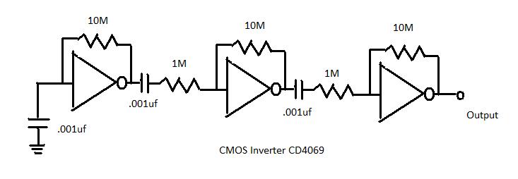

I am experimenting with noise (synth drum sounds). I built this 4069 noise generator. Noise is generated as expected...but it generate a hum sound. First I built it on a breadboard...noise and hum ....since it is very simple I built it (on a small perforate board and solder the components)....noise and hum again....how can I do to get rid of the hum?

Are you operating it from a battery or from a mains source?
Do you have bypass capacitors (a 100 nF and a 100 UF) from Vdd to Gnd?
What an odd circuit.
The input is connected to 0V.
Each amplfieir has a gain of 10, making 1000, in total, I don't see how the amplifier is noisy enough to generate the noise you desire.
Why no go for the traditional zener diode generator?
To answer ljcox - I am operating it with a 9V battery. No I dont have the capacitor bypassing . Do I need two capacitors, both from + and GND?
To Hero999 - I found this on a Patent circuit , so I give a try, and it work...well beside the hum.

The first stage is configured as an oscillator
If you're using a battery, then you only need the 100 nF.
The oscillator has a 10M resistor and a 1 nF capacitor as the timing components.
This means a time constant of 10M * 1 n = 0.01 second.
Thus its frequency will be < 100 Hz which would account for the hum.

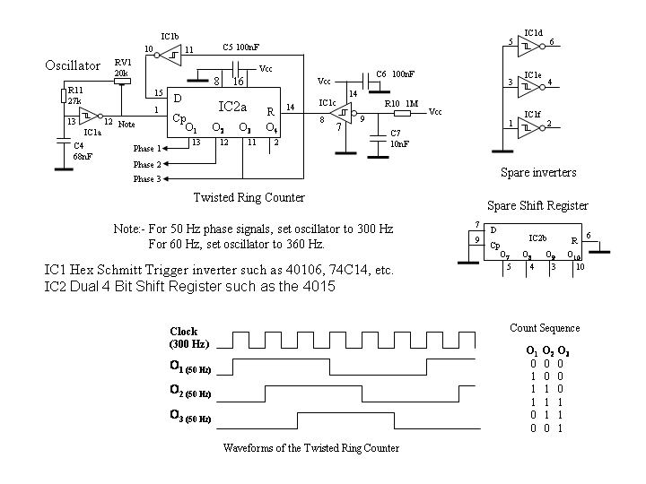

Are you sure? Yes, this is an oscillator config I've used many times. Normally I use a Schmitt Trigger package such as the 71C14.
Where's the feedback? Via the 10 M resistor.
There isn't any unless it's poorly assembled and parasitics are causing oscillation.
Some types of ceramic capacitors are piezoelectric and will act like a microphone picking up acoustic noise.
The attachment shows an example of one of these oscillators.
They are also mentioned in the National Semiconductor Data Book (that I was given many years ago) together with the maths necessary to calculate the frequency of oscillation. I can scan a page or two if you wish.

No, it isn't an oscillator, it's a linear amplifier.
I suggest you compare the two circuits.
Hint: note the difference between a Schmitt trigger and a standard NOT gate.
I know the difference between a Schmitt trigger and an inverter.
But my recollection is that I've seen oscillator circuits where they have used an inverter in this way.
Personally, I would use a Schmitt as the threshold levels are defined and they have regeneration.
A normal inverter can't be used as an oscillator on its own, there needs to be two or more stages.
A normal inverter will go into the linear region when a resistor is connected between the input and output and stabilise at roughly half the supply voltage.
A Schmitt trigger has no stable state so will oscillate if a resistor is connected between the output and input.
To build an oscillator with the CD4069, you need to use two gates.
This circuit is not an oscillator, it's a linear amplifier, the idea seems to be to amplify the noise generated by the first stage 100 times but it doesn't seem to work because the ambient 50/60Hz mains hum is much stronger than the noise generated inside the IC.

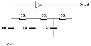

The only way I'm aware of is by using three resistors and capacitors but it looks nothing like the circuit with the Schmitt trigger.
