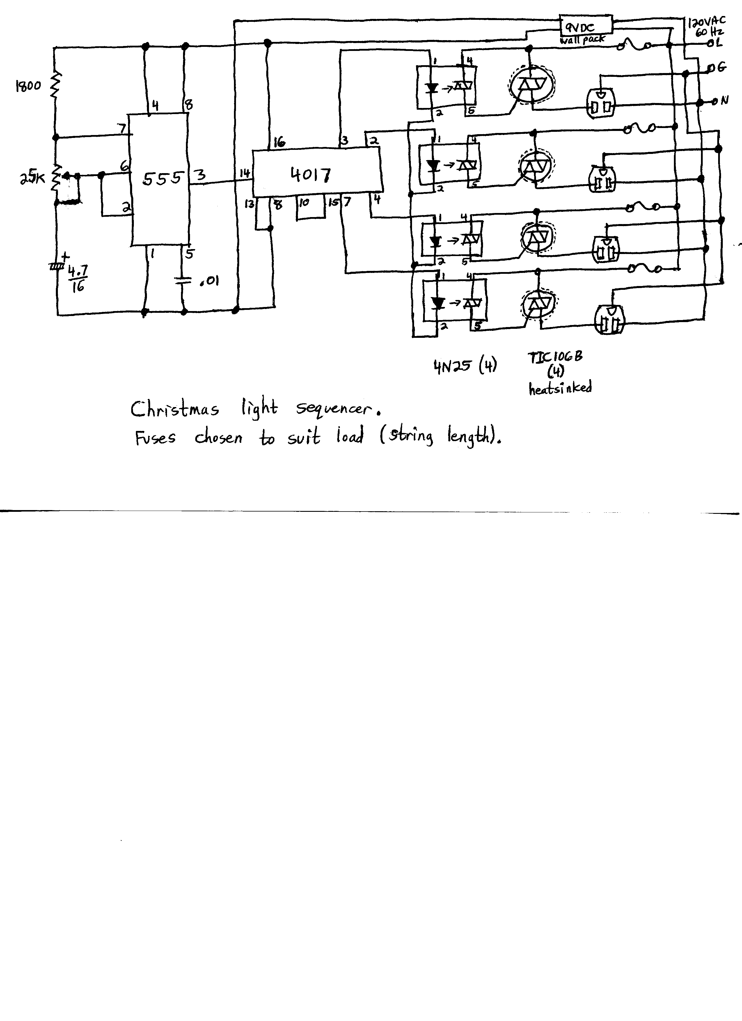

Modify my circuit, replacing the optos with relays.
