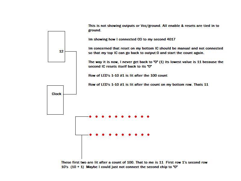

Hi All, I want to connect 2 decade counters so I can count to 100. I thought to do that you used 2 4017's and the divide by 10 output was the clock input to the second 4017. I put it all together and it went crazy because I think I have some bad pin sockets, is that the way they work or should I clock input the second 4017 from the 9 output on the first 4017 ?

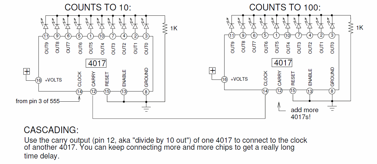

You use the CO (Carry Out) pin 12 of the first stage to feed the clock in of the second stage. You are "Cascading" the 4017s.

These dont have CO pins, they have "divide by 10" that must be it right, cuz it was working except I dont think that second counters reset is supposed to bring grounded or held low ? because I can never get back to one.
You really need to look at the datasheet and pay attention to pin 12 as already advised by Reloadron.
OK, one more time. Note the attached image. It is taken directly from the link I posted earlier. The 4017 is a Decade Counter / Decoder and Pin 12 is known as a CO (Carry Out) as in when the counter counts 0 through 9 you get a carry function. Each positive clock transition at pin 14 (Clock In) advances the counter one count. During clock pulses 0 through 4 pin 12 remains low and then clock pulses 5 through 9 it transitions high. This is how 4017 counters are cascaded. Look at the image. Additionally it clearly shows how to tie your remaining pins to do what you want to do.

Reload, Thanks I didnt see that last night, I just drew what mine was doing and I see you dont need to connect zero on the second IC, Thanks. Jim

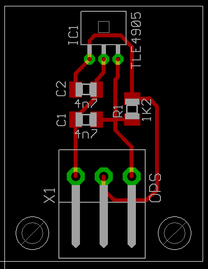

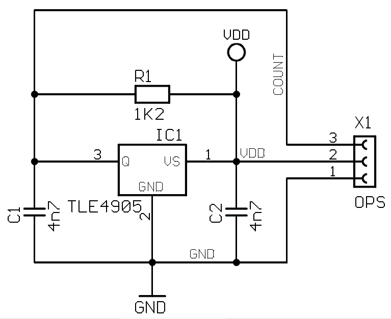

Here is a way to avoid false clocking (switch bouncing) of the counter(s).
The TLE4905 (Infineon Technologies) Hall sensor provides clean square wave outputs to be used as clock signal.
Board size is 0.7X0.9inches.
PM me for Eagle files.
Boncuk
