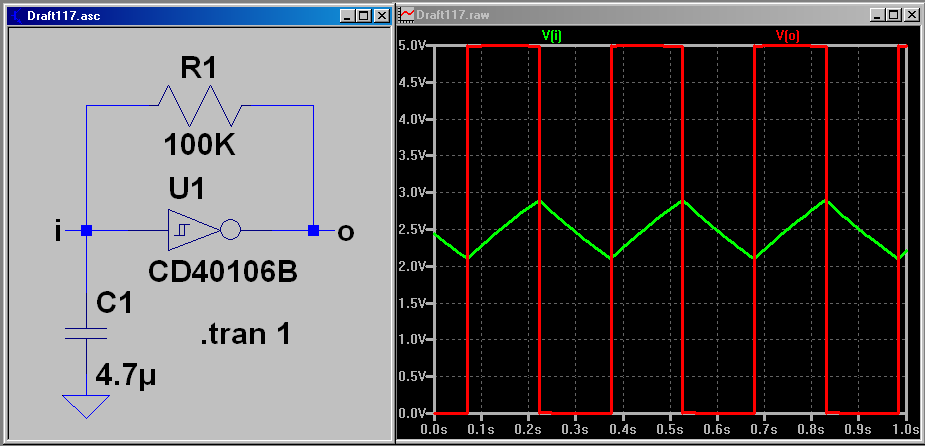

Hello all, I am working on building an oscillator using a 40106. So far I have only been able to get one oscillator out of the 40106. I should be able to get several from a single IC.
DC connected to pin 14
Ground to pin 7
A 4.7 uf capacitor is connected to pin 1 from ground,
A wire is connecting pin 1 to pin 2
A 100 K resistor is connecting pin 2 to pin 3
and my output is pin 4
After looking at several examples online, I should be able to connect my capacitor to pin 1,
my resistor between pin 1 and 2
and have my output be pin 2
but this has yet to work, I am trying to create a dual oscillator but need the single oscillator to work first before i can move forward,
any suggestions?
Works in LTSpice. Try a higher value (>50K, < 5meg) for the resistor. You can make the capacitor smaller, as long as it is >~100pF.

i am connecting the possitive wire of a small speaker to pin two and grounding the negative, i should be able to hear audio correct? i can hear it in the set up posted with my question but i can not hear it when trying these connections.
should i be using a potentiometer for my resistor, i know thats a dumb question, but this still isnt working.

A CMOS inverter cannot drive a speaker; as I told several posts ago, you need an audio power amplifer.
Feed the signal at the inverter output into your home stereo, or your powered computer speakers.
If you use a pot, put a fixed resistor of ~20K in series with it.
IT WORKS! i connected the 40103 to a 741 audio amp and it works, thank you for all of your help everyone. im sure i will have many more questions, i am very new at this
