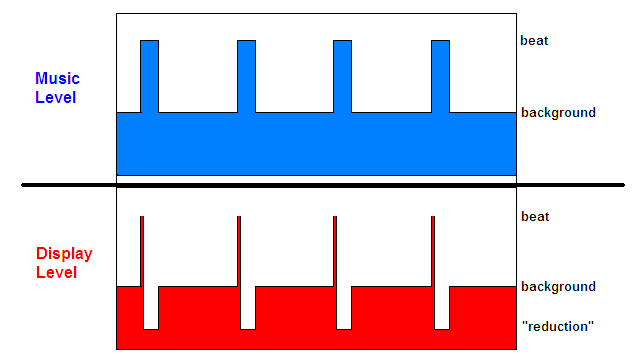

You designed a very complicated circuit. I don't know why you selected only 1dB steps when nobody can hear such a small change in level. I have a 3dB-steps meter made with two cascaded LM3915 ICs that accurately shows on its 20 LEDs a range of levels much greater than yours.
On your video, frequently the peaks aren't seen. Then the peaks are immediately followed by a reduction in overall level which is odd. For most of the video I didn't see the peaks, saw the reductions and thought the displays were upside-down.
I am used to seeing a VU-meter that holds the peaks long enough to see them, about 40ms. Then an RC discharge time fast enough so that 50Hz is still accurate.
It would be good to make a VU-meter like those on stereos. One LED holds the peak for a while and the other LEDs are instantaneous. :lol:

Do you also think this LED meter appears to operate "upside-down" with a reduction immediately following a peak? :?:

I don't quite know what you mean?, if you're holding the peak (so you have time to see it), then the only way it can go from there is down.
With an analogue meter you don't see the signal drop rapidly away (because the peak holds it), but with an LED display it's usual to not only hold the peak, but also to show the lower LED's falling away as well.

I played the video and sounds again and saw it again.
In the beginning and near the end when the entire "orchestra" is playing, the overall level appears to drop about 8 LEDs for each beat. I don't see the instantaneous peaks, maybe because they are so fast, or maybe because the circuit messes-up and reduces the level of the display when it shouldn't during each beat.
In the middle of the video during the orphan drum-beats (without any other sounds) then the display appears to operate normally showing very fast rise and fall swings including the duration of the peaks.
You know what?! The faulty "compressor" in the DSP of my old car radio behaved like that. It over-compressed for each beat of the music. It drove me nuts because it messed-up the sound, not just the display.
It messed-up only the sounds of its FM radio, its CD player sounded perfect. I nearly called my favourite FM station to complain about their "over-compression" then I heard the station playing perfectly on my sound system at home. :lol:
You'll know what I mean when you see my sketch:
