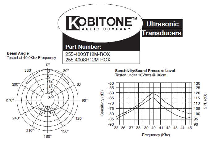

The piezo transducer resonates at 40kHz so sweeping its frequency enough might not be possible. Since it resonates then the squarewave input produces a sinewave sound that is low in harmonics.
Check its datasheet to see its bandwidth.
The specs of the transducers are unknown. I did a check with a square wave at different frequencues. The receiver detects them all, so that part seems to work.
Google showed that Mouser sells many piezo ultrasonic transducers. Here is the datasheet showing the narrow bandwidth of a typical transmitter and receiver:

Audioguru,
Based on your reaction I decided to do a bit more of a thorough check on the frequency band, and it looks like you are absolutely right (thanks for the effort!).
Below a Bode plot from the transducer on top of the receiver, it shows a narrow bandwidth from about 36 to 46 kHz (note frequency band is not on log scale).
Nice to see there is a second band at 57 kHz.
I'm in doubt if this would work for a chirp based sonar..
Any thoughts on the usability?
Thanks,

In the end I have to conclude that the transducers are not suited for chirp based sonar due to their limit bandwidth.
For the receiver to get into a forced oscillation (not 40 kHz), the arriving pulse has to have a significant length and has to be powerfull enough.
at a distance > 10 cm the power of the received signal is simply not enough to force an oscillation other than resonant (which occurs up to 3 meters).
I'll think drop down to the 1~10 kHz range where standard microphones/speakers can be used, with bit more bandwidth.
