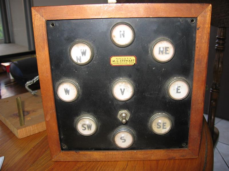

I have a 1800's style US Weather Bureau mechanical wind-vane device, with a later style (1950's - 60's?) indicator-light panel. When I got them, no wires connected the two together. There must have been a tube type answer before, but if I can fit the "new" interface in the existing light box, which has room at the corners (the lights are in a circle), I'll use any solution.
DESCRIPTION

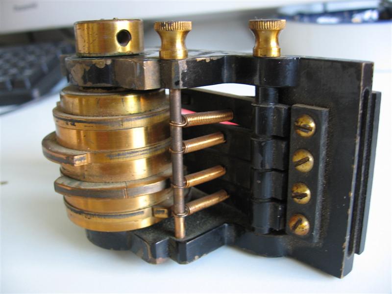

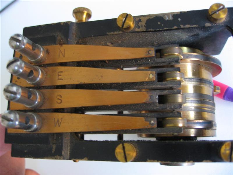

Simple enough: the wind-vane contact device is heavy brass by Julien P. Friez (Balt.) in the style of a music-box; there are 4 output terminals and a ground terminal. The 4 raised areas on a spool close 1 or 2 of the 4 brass contact outputs when the spool rotates. The elevated sections overlap so that when the wind is between N and E say, both N and E contacts close.
The display panel is by MC Stewart (Boston), and has N, E, S, W, and NE, SE, NW, SW, and "V" lamps (I assume the V means voltage). with on/off switch inline with a common ground to all 8 lamps, and each lamp has it's own a wire going to the center post. However, I can't tell what type of lamps these are, DC I assume. They're like auto-side light types: small, glass is same witdth as the base, with fairly bright blue insulator keeping the two terminals apart. It is a modern screw-in lamp. Has "46" stamped in black on the base, but nothing else. 2.7 ohms across the terminals.

Looking at the pics, it looks as though the cams/switches maybe already 'coded'.[ they don't look like quadrants?]
Can you post a sketch of the 4 cams, that is, highs/lows and in the same orientation as they are mounted?

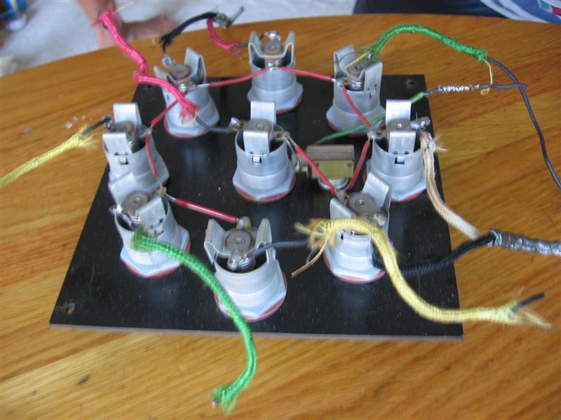

The lamp holders appear to be threaded, more like a lamp type screw bulb, with a single centre pole.
If you have a 0 to 12Volt dc power supply, connect one lamp, start at 0V from the psu and turn up the voltage very slowly
do this until the lamps appear bright enough to illuminate the legend.
Lets know what you get.

The switch cams are cut to suit a pattern as per the attached GIF.
The High of the cam closes the corresponding switch.

If you check the highs/lows on the cams driving the switches I expect you find that they are 'encoded' as I have shown my drawings.
IMO you dont need semi-conductor logic to drive the lamps from the cam switches, remember the circa dates 1800's 1950's, no semi's as we know them today.
If you want to upgrade the electronics I would still suggest that you checkout the cam encoding, its most likely not binary:rolleyes:

upon testing per your diagram, i hook up 4 lights (leaving 4 not hooked up) to the 4 cam terms (as you specified): n-n, e-e, s-s, w-w. when i rotate it, it performs as i expected, and I see in your drawing. Here are the results:
When starting at N, N is lit alone. Rotating through toward E you will see N and E light up simultaneously for the same time N and E light up independently. i.e. the lit order goes like this: N (for 45deg); N+E (for 45deg); E (for 45deg); E+S; S; S+W; W; W+N. (in theory, roughly 45deg for every light, right? NE is lit from 22.5deg to 67.5deg; east becomes lit at 67.5 and through to 112.5 )
So I believe my truth table in the first post tell the correct story (yours may, but i just don't see it) and where 1 is on, 0 is off. yours was opposite maybe?
mine:
N-E-S-W --> desired light (1 of 8)
1-0-0-0 --> North lights up
1-1-0-0 --> NE (the intended behavior is to not light up the N or E at all, but light up NE (like an AND gate from N and E)
