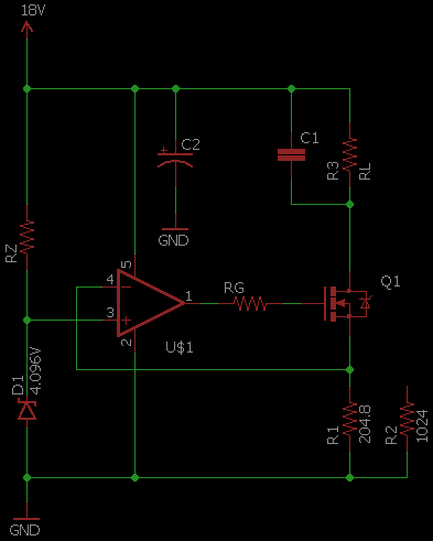

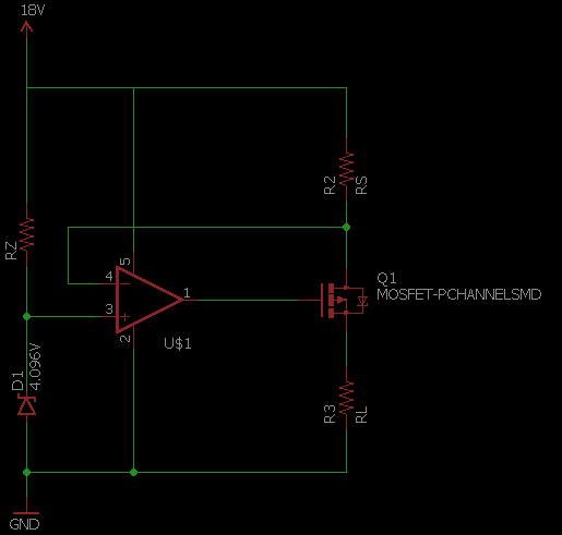

Essentially, this is what Im thinking of. RL wont be there on board, it will be off board. Values have not been picked other than my power source (which is 2 9V batteries) and Reference voltage. RS sets the Current out, in this case Vref/Rs. I chose 4.096V because it gives me a larger range of resistances to choose from.

The 4.096V needs to be across RS. What you have places 9-4.096 across RS.
Here is something I got from an011. There is an error around VR1 but the rest looks good.
D1 is there to make pin-4 of op-amp 0.6V below ground. Many amps do not work well if the inputs/outputs get too close to the power supply voltage.
Hmm, Well Ive reduced that schematic down to the bare basics, ie without all the fluff, as far as my understanding goes. I dont need it to work at low input voltages, so I removed R2, R3 ,R4 and VR1. Instead I will change R6 (Called out as R1/R2 in my schematic to vary the current). However, it might be more beneficial to use the same method via a switch to vary the current as the original author did, as I am finding out that the resistors needed aren't going to be avaiable anyway. For a 4.096V Reference, I would need 204.8 Ohms and 1024 Ohms for 20 and 4mA respectively. I am finding out that the closest value is 205 Ohms and 1020 Ohms with 0.1% Accuracy.
I also removed D1, but Im slightly unsure about *not* keeping it, only because it does serve to bias the negative side slightly to make the op-amp float.

You can always use a second resistor in series or in parallel with a standard value sense resistor to trim it to the custom value you want.
Looks good.
I would keep the 4mA resistor in all the time and then switch in a 16mA resistor for a total of 20mA. (simple switch)
You could have a three position switch for 4mA, 0mA, 20mA. (center off switch)
