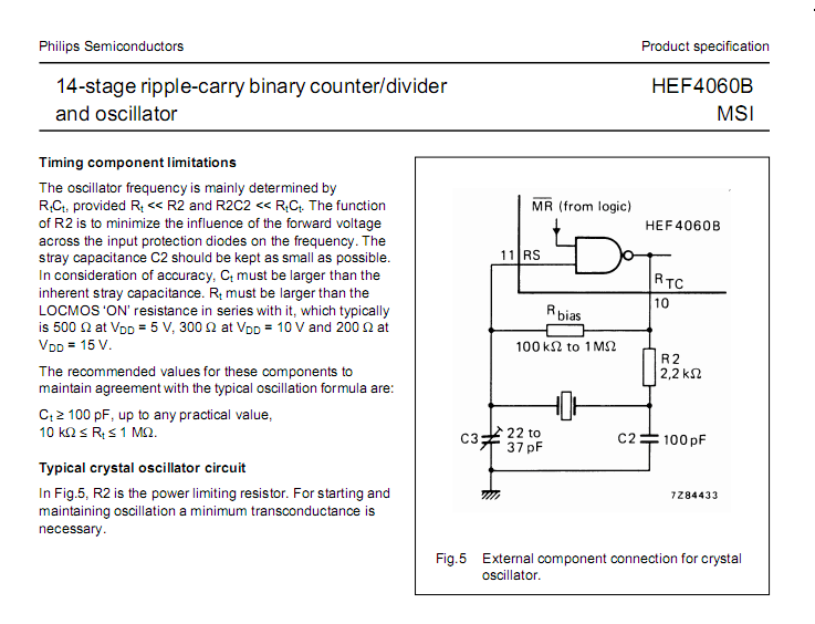

Hello ! I've tried to connect 4,096MHz quartz crystall to 4060 IC, but unfortunately it doesn't work :( I get too slow frequency ...
Here's the scheme I've used:
I've connected everything like shown, except I've put in the 4,096MHz crystal. And it doesn't work. Could it be because of resistors' and capacitors' values? How can I calculate what values should I use? Does anyone have another scheme with 4060 and 4,096MHz crystal?
Thanks for help :)
The resistor values for the xtal are far too high, look at this image.

Wow, values are really too high, I'll try with values from your images, thanks :D
Just one question ... It says for one resistor that it should be from 100k to 1M ... Should I just pick one value or do I have to calculate it somehow ??

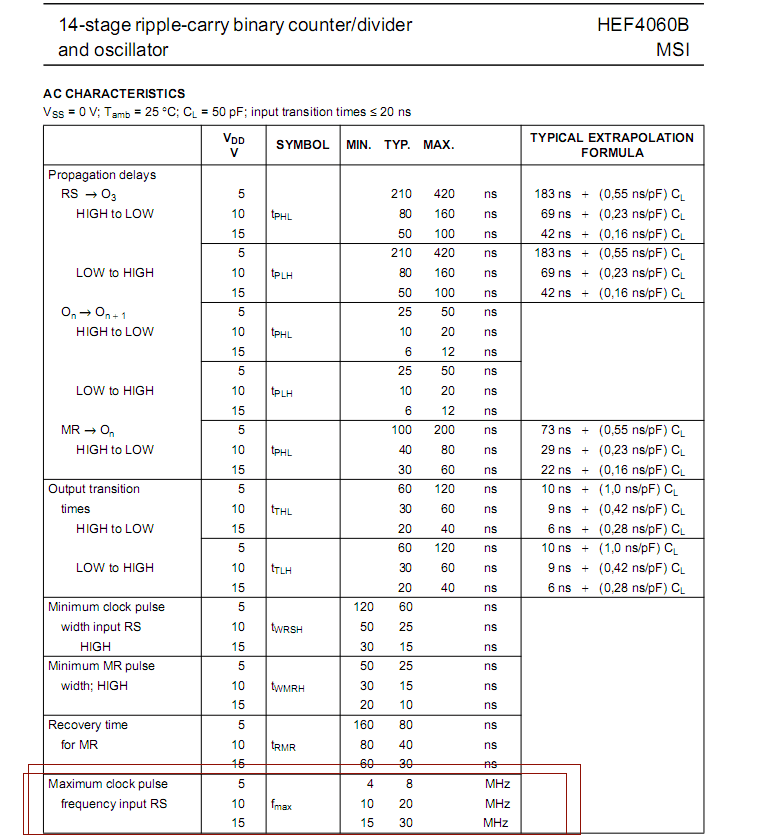

What is the supply voltage for the CD4060? At 5V that device is only good up to 3.5MHz.

Which technology is your 4060.??
eg: HEF or HCT or CD etc... the modern versions will work well over 4MHz at 5v.
The problem with the HEF4060 is that its upper frequency is rather low, and crystals at less than 10 MHz or so are more difficult to get to oscillate.

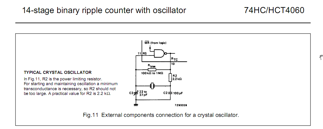

It would be easier to use an HC4060 and a 16.384 MHz crystal. You won't need the series resistance (the 330k one) at all. connect the crystal directly to pins 10 and 11.
BTW, there is virtually no difference between the HCT4060 and the HC4060. The only difference is the input level of the MR input. All other characteristics are the same, and the clock input has the same voltage levels on both types.

A ~4MHZ crystal should work without any problems when using a HEF4060.

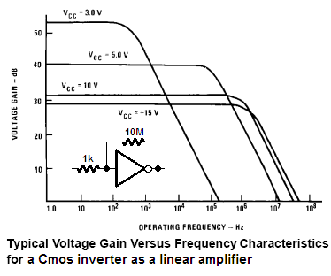

The max clock pulse frequency is the frequency for the digital counter, not for the analog crystal oscillator.
The minimum oscillator frequency is important not the maximum frequency.
I have a graph that shows typical the frequency response of a linear inverter in a crystal oscillator. There is a little gain at a few MHz when the supply is only 5V. 10V is much better. Devices with minimum spec's have reduced high frequencies. Circuits built on a breadboard also have reduced high frequencies.
