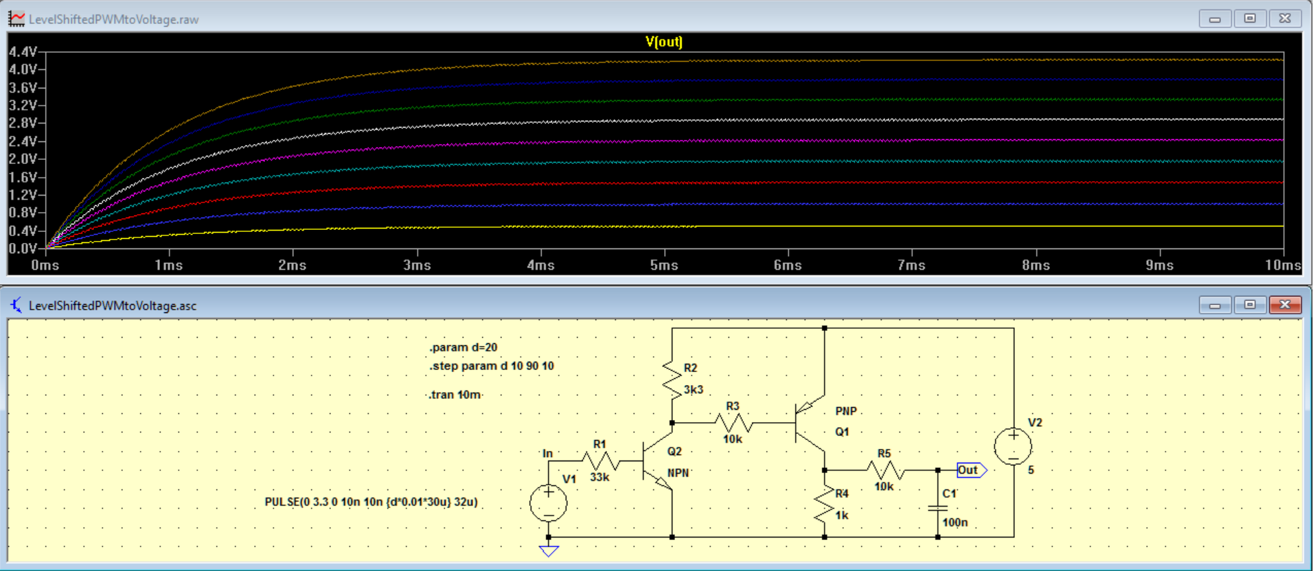

Anyone got any clever ideas as to how to do this elegantly? Everything I come up with seems too bulky.
I should add: And try keep it as linear as possible.
PWM @ 30-40kHz
Is this close enough?
The graphs are for PWM duty cycles of 10% to 90% at 10% intervals.
  • LevelShiftedPWMtoVoltage.asc
Ah nice Alec - that'll work. I had a similar version, but I think my cap was too big because it didn't work very well.
I tried an opamp version, low pass into amplifier, but unless its properly rail to rail you lose a lot.
Here's an alternative, giving a better approximation to linear :-
  • LevelShiftedPWMtoVoltage2.asc
