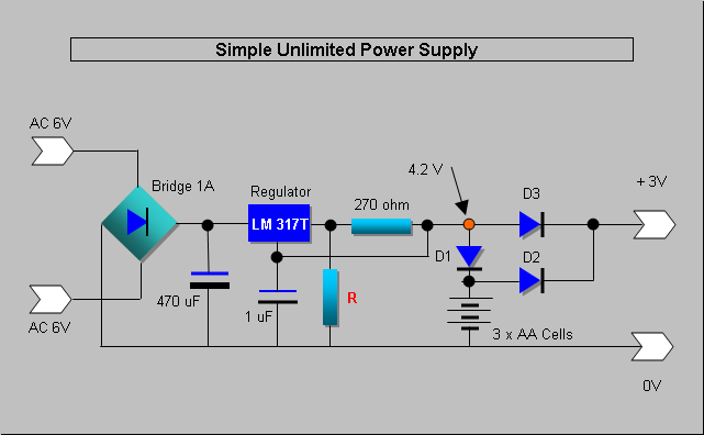

Hi everybody! This time I’m building an unlimited power supply. Bcuz I have a circuit that needs continuous 2.5 V-5V DC supply even the AC power is there or not. So I designed a simple solution for this as below.
See Pic1
I used a 6V/300mA transformer for this. I couldn’t find any 3V ones & I’m too lazy to rewind that transformer for 3V. The bridge rectifiers makes the waveform to DC & 470 uF capacitor makes it little smoother as in the normal Power Packs. The DC voltage is directly applied to the LM 317T voltage regulator. I have adjusted the R to make the output as 4.2V.you can see in the diagram.
When the AC power is available the output 4.2V of the regulator is going through D1 as well as through D3 to the output. The D1 is the charging path of the Batteries.
1. When the batteries are fully charged the current is going directly through D3 to the circuit. Not going through D1 & D2 Isn’t it????
2. Is this good charging all the time the batteries????
When the AC lines fails the battery taken over the run. Then Current is flowing through D2. This time the voltage will be (1.2Vx3) – 0.6V = 3.0V.This is enough to hold my circuit until the AC power comes.
But I don’t like much this serial charging method. B’cuz all three batteries are not constant. One battery can fully discharge & the other one can be half charged. So when charging when the first battery is fully charged it won’t allow current to flow to the other batteries. If I have a single battery this wont be a problem. But I have 1.2V batteries.

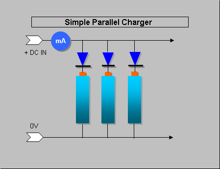

I cannot add below method to this circuit. The parallel charging method (one by one).
See Pic2
I need some advice from you about this batteries serial charging. Is my cct having a problem?? Any modifications to be done etc….
I like to do this with two AA batteries but the D2 diode will drop 0.6V so the output will be 1.8V.
The batteries I’m using GP batteries AA (Gold Peak) 1.2V, 2550 mAh, Standard charge 16hrs, 250mA.
In general, no. SLA or Sealed Lead Acid do well with a constant voltage trickle charge method but most other types do not tolerate this too well.
These sound like NIMH batteries which do NOT work well when on constant trickle charge.
Change them to NICAD type and limit the charge current at around 0.02C - 0.05C. So if the batteries are rated for 1000mAh then trickle charge them between 20-50ma... If you already have the NIMH, then you can use them but expect a shorter lifespan compared to the NICADs in this configuration.

As per your diagram; the problem with charging the batteries through D1 has several problems:
1: The current is not limited. Well it is, but it's at the max rating of the LM317!
2: 4.2V - 0.7V (diode) = 3.5V which means that the batteries will never fully charge because the voltage accross a NIMH/NICAD usually needs to go up to apx 1.6V per cell which would be 4.8V for 3 cells.
There is nothing wrong with charging the batteries in series. With a trickle charge, the batteries will equalize over time.
Below is how I would do it. You would choose R1 to limit the trickle charge rate to 0.02C - 0.05C. D1 would be a schottky diode and the regulator a Low Drop Out type to minimize voltage drop. You'd probably be better off using 4 NICAD cells and a slightly higher AC input voltage to give you more room for line voltage variations, etc.

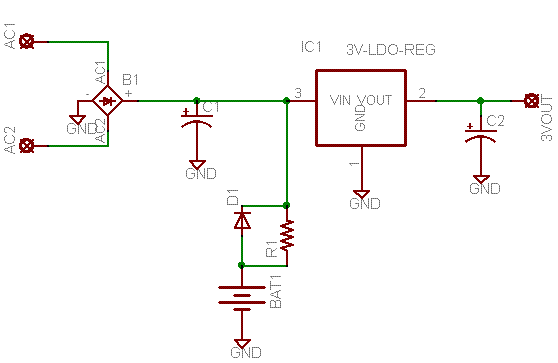

Hi kchriste thanks for your explanation. I went through your diagram. Earlier I planed to put the regulator in the output side as in your diagram. But I couldn’t find any LDO type regulators in my place all I have cheapy LM317T & 78xx series. So I planned to put that in the input side.
Your schottky diode is very usefull in this case with low drop forward voltages.I must give input voltage about 1.6Vx3=4.8V as you said & also add a R1 resistor to limit the current.

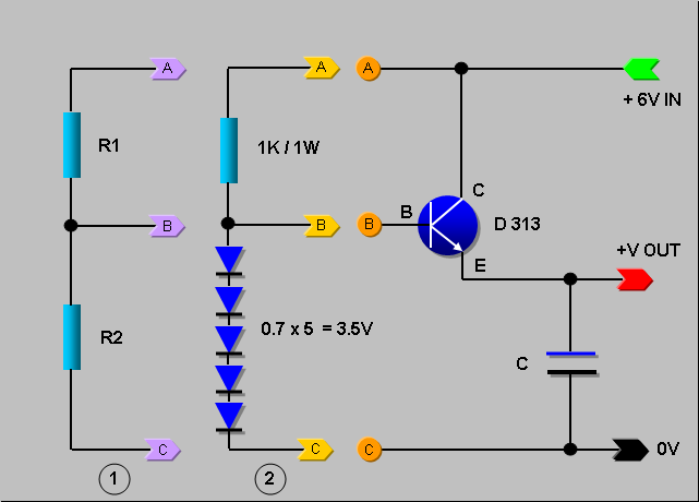

Hi…..I refreshed my basic knowledge to replace this LDO type regulator. Instead of the regulator I made it with a transistor as in the diagram below & I checked in my breadboard. It worked well giving output to 3V.
Look again. It's set up as a 4.6mA current source. It won't work as a UPS, but it is current limited.
I noticed that today. It won't work very well as a charger for a 2550mAh battery either then. Not to mention the 200mA required by the "PIC based small sensor circuit", which would drain the battery with no chance of it charging again, so I let it go as a drawing error.... ;)
Now draw 200ma out of it and see how low the input voltage can go before the output voltage drops below 2.7V Maybe change the 1K resistor to 100:eek:hm: @ 1/2watt and you should be able to get a lower dropout voltage. I suspect that you won't be able to get the performance that you want from this circuit.
