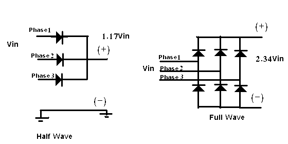

I want to design a power supply with 3 phase input to get 2.5A DC.
Please share your ideas or guide me with block diagrams.
Thanks in advance!
Like Driver300 said, however 3 phase gives higher dc than input AC while single phase gives less also 3 phase gives less ripple and in full wave you will not need large electrolytic capacitor, so it is better for high voltage but for low voltages, it will cost more on the transformer.
attaches is the general idea of 3phase half and full wave, hope that what you need
