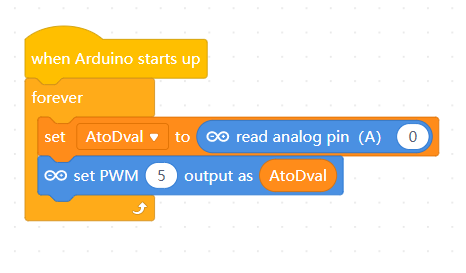

I use ATTINY85 to get delays, triggers, intelligence. Easy to spin a program,
I use block programming mostly with these, even though I have done many
languages since 70's, including C. Its quick and fast for simple stuff. The timing
is much more accurate, unlike a 555 dinosaur. +/- 1% with simple user cal
procedure.
An example of a flex timer application -
https://www.electro-tech-online.com/articles/pulse-sequence-generator-smart-timer.938/
Here is an example of that it took to make a V to PW converter -
mBlock, converts your blocks to Arduino code, and programs the board/part.
