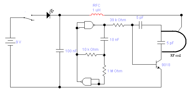

Then I have to draw it, because the schematic doesn't come together, only the layout. But the transmitter is really simple. A 2 input NAND gate IC (only 2 being used), a RFC, a few capacitors and a few resistors. I can see that the tag switch turns the whole circuit on and off.

If it uses a 2 input NAND gate, you may be able to modulate it by controlling one of the inputs. Post the circuit so we can help.

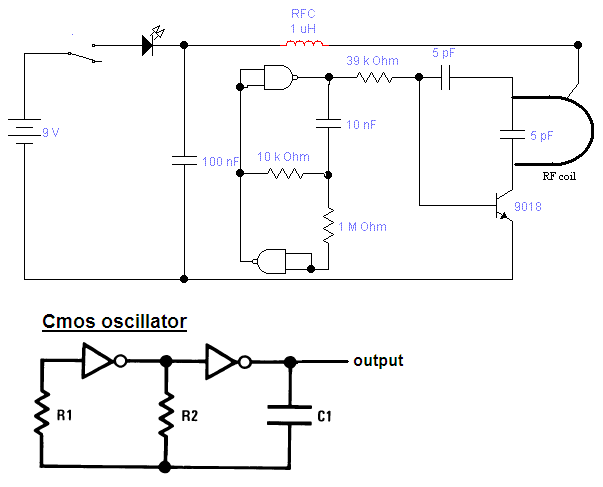

This is the transmitter circuit.The RF coil is on the PCB. I couldn't find the schematic of the receiver yet, maybe I have to draw it according to the layout. Can I replace the 9018 npn transistor with other transistor? And, can I know any method of modulation?
Remove one NAND gate input and this will be the modulation input.
I'm not an expert on RF transistors, perhaps someone else can advise you.
I think the transistor is the 300MHz oscillator and it is turned on and off at an audio frequency by the classic Cmos oscillator made from two Nand gates.
The Cmos oscillator can be stopped by diconnecting the input of one gate from the circuit and grounding it, then started with a resistor that pulls the input high.

That module is nothing but a simple 'FM bug' RF oscillator tuned to 300MHz with a NAND gate oscillator modulating it. Here was me thinking that those expensive modules were generally well-designed and worth the money.
Look the NOT gate oscillator audioguru posted and look at the NAND gate oscillator on the transmitter schematic. Notice how they are essentially the same except yours uses NANDs while his uses NOTs?
There are two ways of making a NOT from an NAND aren't there? You can either tie the two inputs together or tie one output to +V, if you do the latter using a pull-up resistor it will work as a NOT gate but if you ground the other input it won't work. This is exactly what you do with your circuit you cut the link between two of the inputs on either of the gates, and use the disconnected input as an enable pin.

How do you know the NAND produce audio frequency?
Because I am a smarty-pants geek! It is about 7kHz but I looked on a graph without calculating it.
Do you mean, .....
Like my sketch. The on-off switch can be a transistor. The resistor and switch can be the output of a microcontroller.
