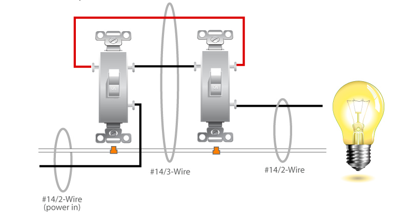

Ok so as you see in the title here im trying to find out how or where to get a 3 way DC switch that has a built in LED to control a single light with 2 switches like you would for AC 3 way switches , I also would like it to where you see the led's when the light is switched off for night time for solar backup system.
Does anyone have any sources for such switches?? Granted i know there are double pole 2 way switches to control 2 lights with 1 switch but thats not what i need, someone said to wire in the second switch the same way the first one gets wired but then you cant turn your light off unless the other switch is off too.
Is this what you call a 3 way AC switch?

A 3-way light switch is just a simple Single Pole-Double Throw switch.
So any SPDT switch rated for the voltage and current of your load will do. Just search for ones that have an integrated LED. Or place a discreet LED nearby.

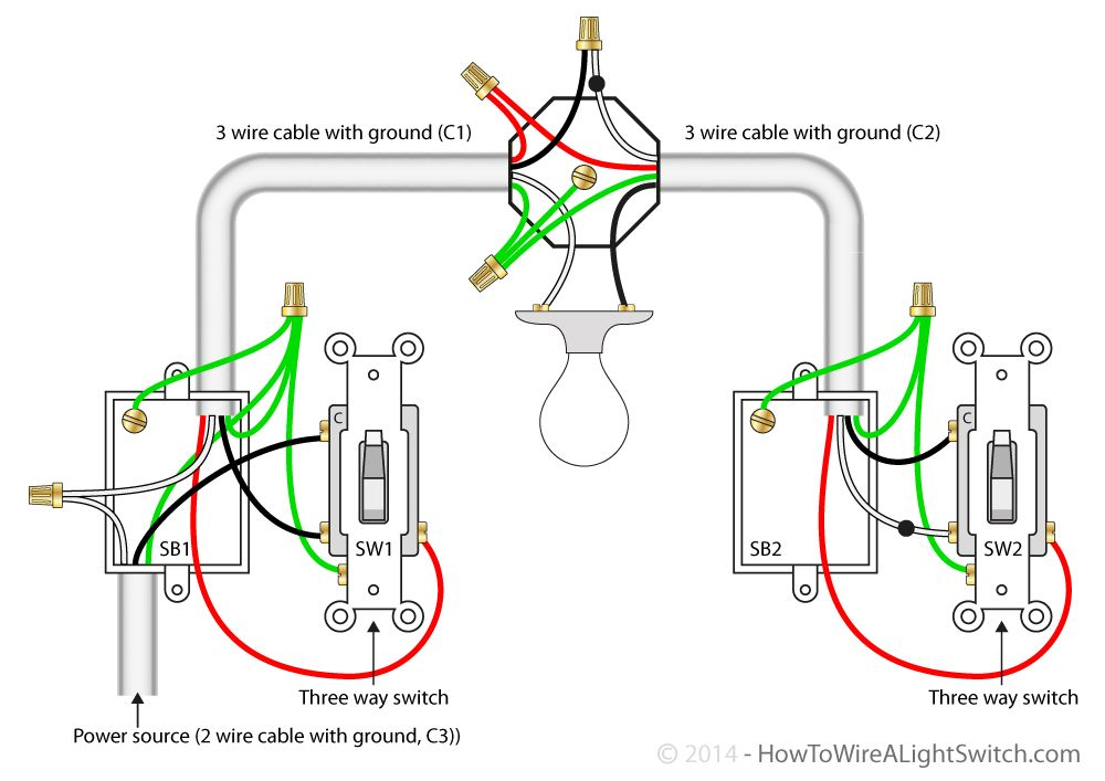

If you are wanting to control 1 light with 3 switches this is how its done in the Uk(maybe other countries too).
A double pole 6 terminal switch could be used for all 3 switches, 2 of them having 3 unused terminals, however the indicators in the switch would not mimic the lamp being controlled, you would need a double pole switch with seperate Led indicator connections for that, I've only seen such switches as industrial selector switches which are expensive.
