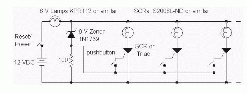

hello, can you help me on this project. Can you post on this thread the schematic & the circuit of 3 relay buzzer.. when the 1st gamer push the button automatically the other two gamer shutoff their button buzzer.. thx :)
I have Several circuits If you need more just email me
