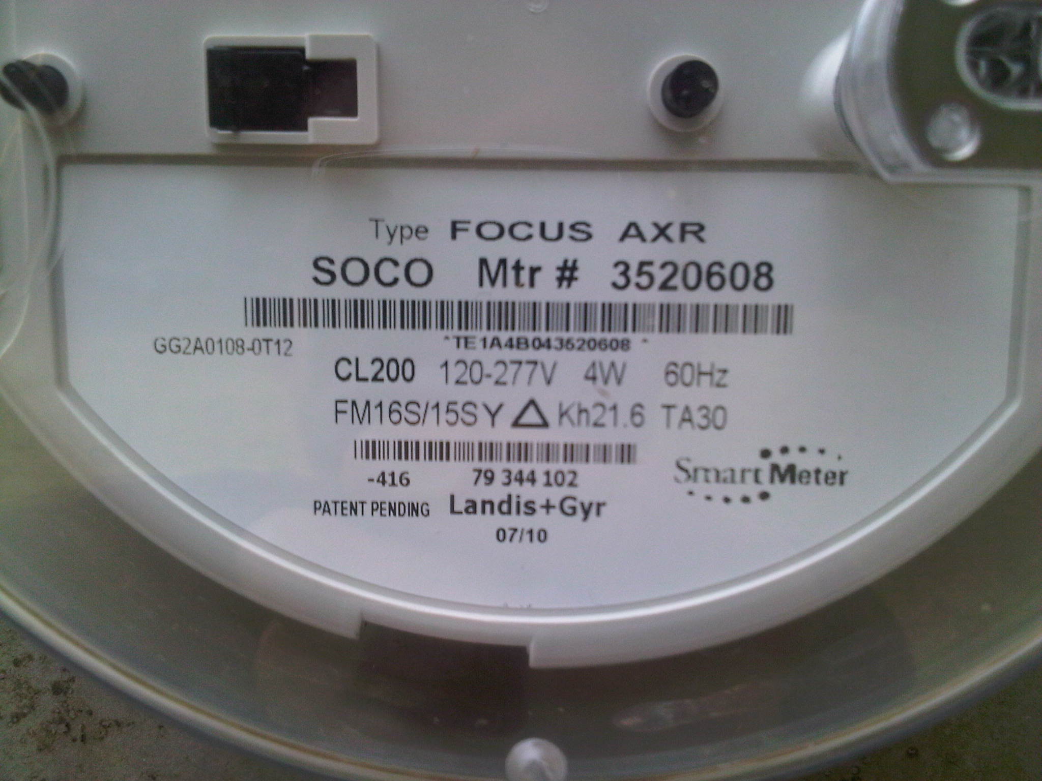

I am planning to take some pictures of the transformer on the street and the main panel inside to post. I have this close up of the meter.

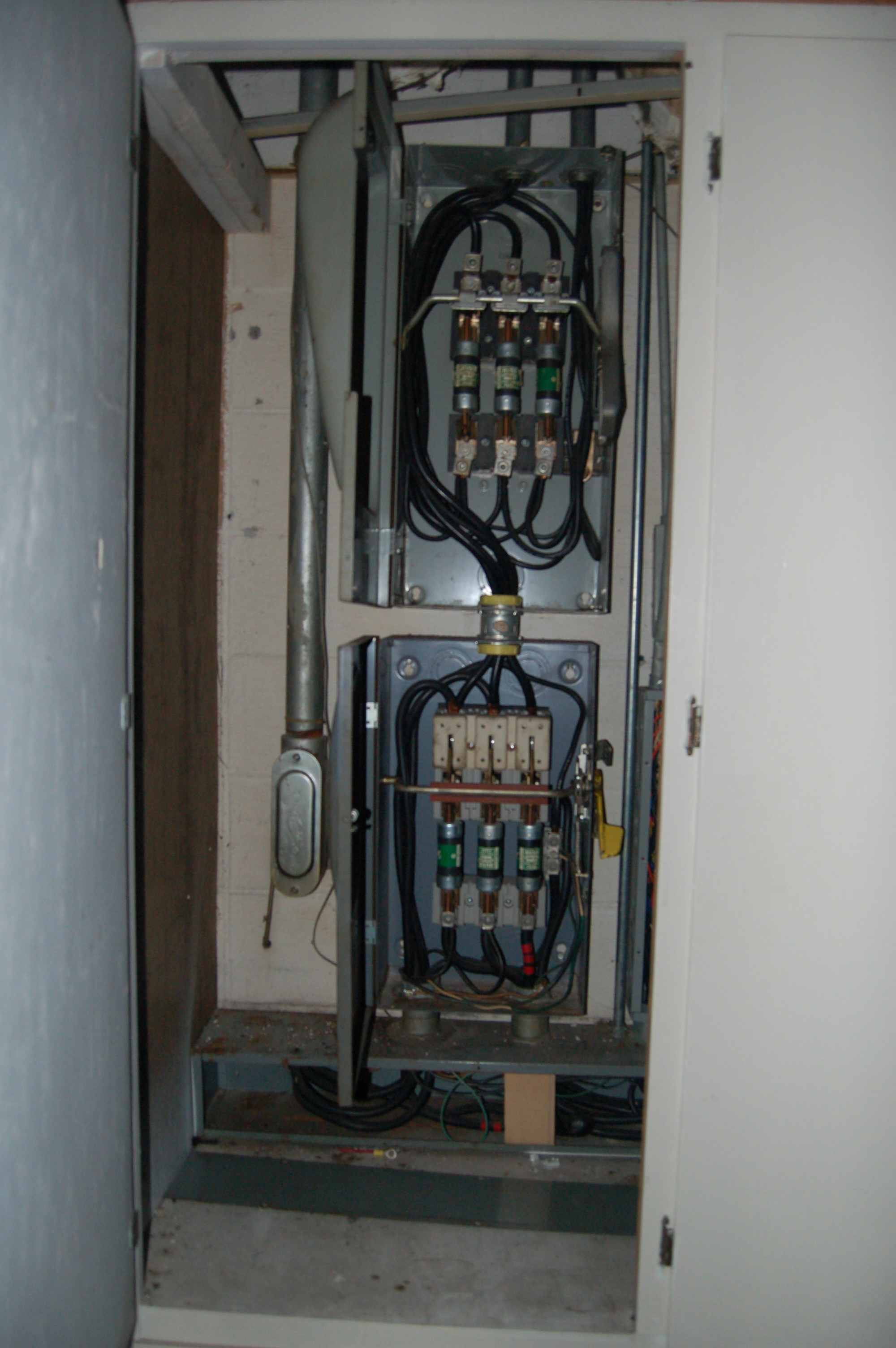

the main panel is on the bottom, the one on top goes to two 3phase panels across the shop.

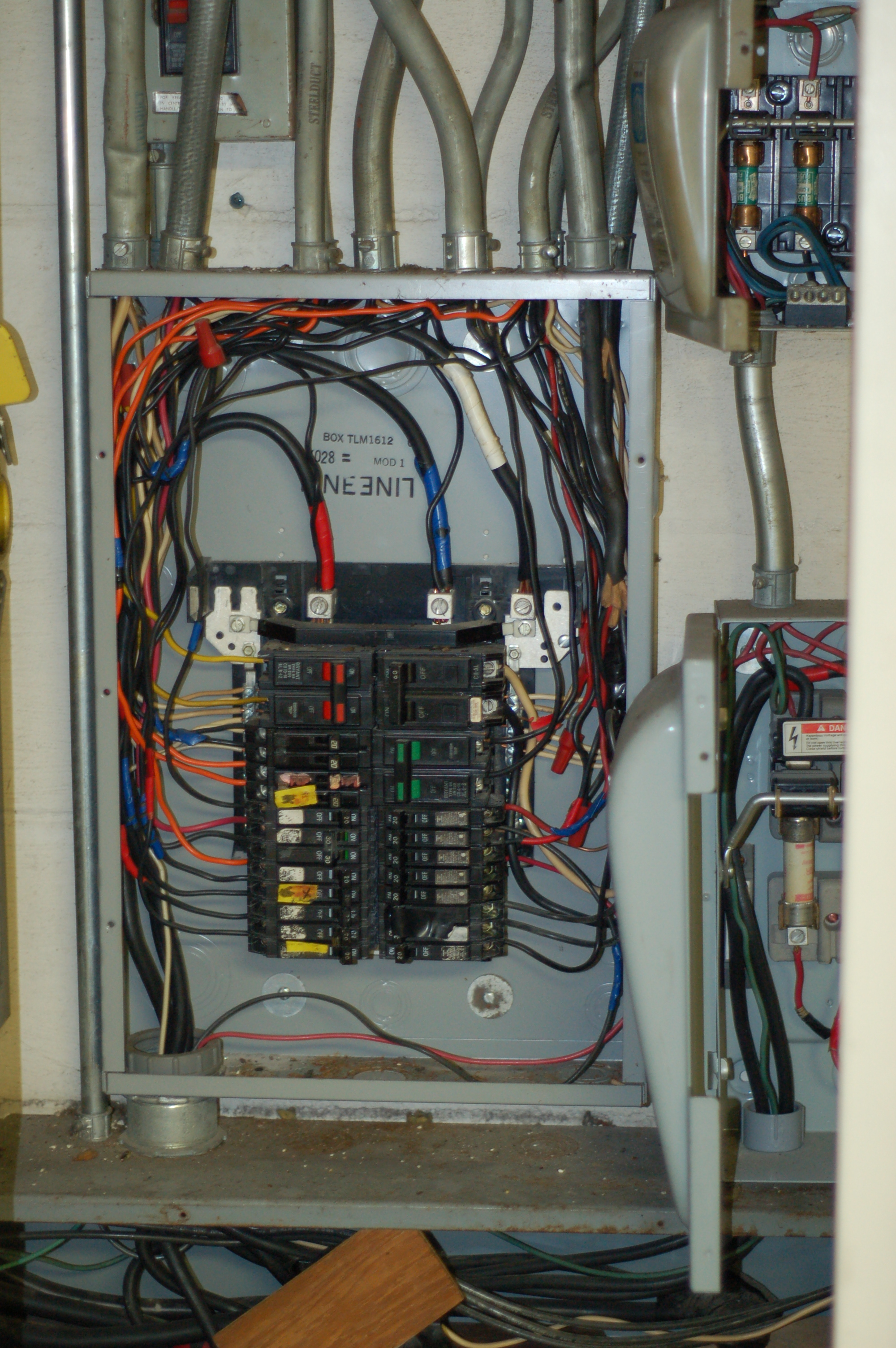

If you zoom in on the bottom panel you can see that one of the main lines in is marked with red tape. the other two are supplying the single phase panel in the next picture.
In the "single phase" box, measure the voltage between the wire with the red tape and the one with the white tape. That is most likely your 120V. Also, you should have 120V from the blue tape and white tape. If so, then any single pole breaker should give you 120V and any two pole breaker should be your 240 or 208V. You can make these voltage measurements safely, but pay attention to what you're doing, and please be careful.

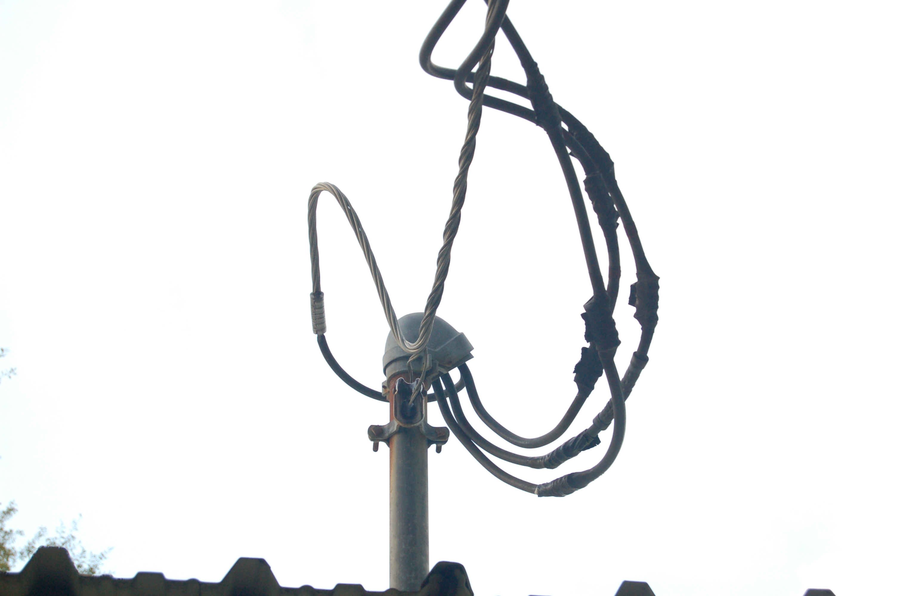

See the uninsultaed wire in your picture of the weather head? That is your neutral, and suggests a wye scheme. Also, note the wire with the white tape, and how it's connected to the frame of your box and not the power rails (there is a strip where all the neutral returns connect together). That is your neutral.

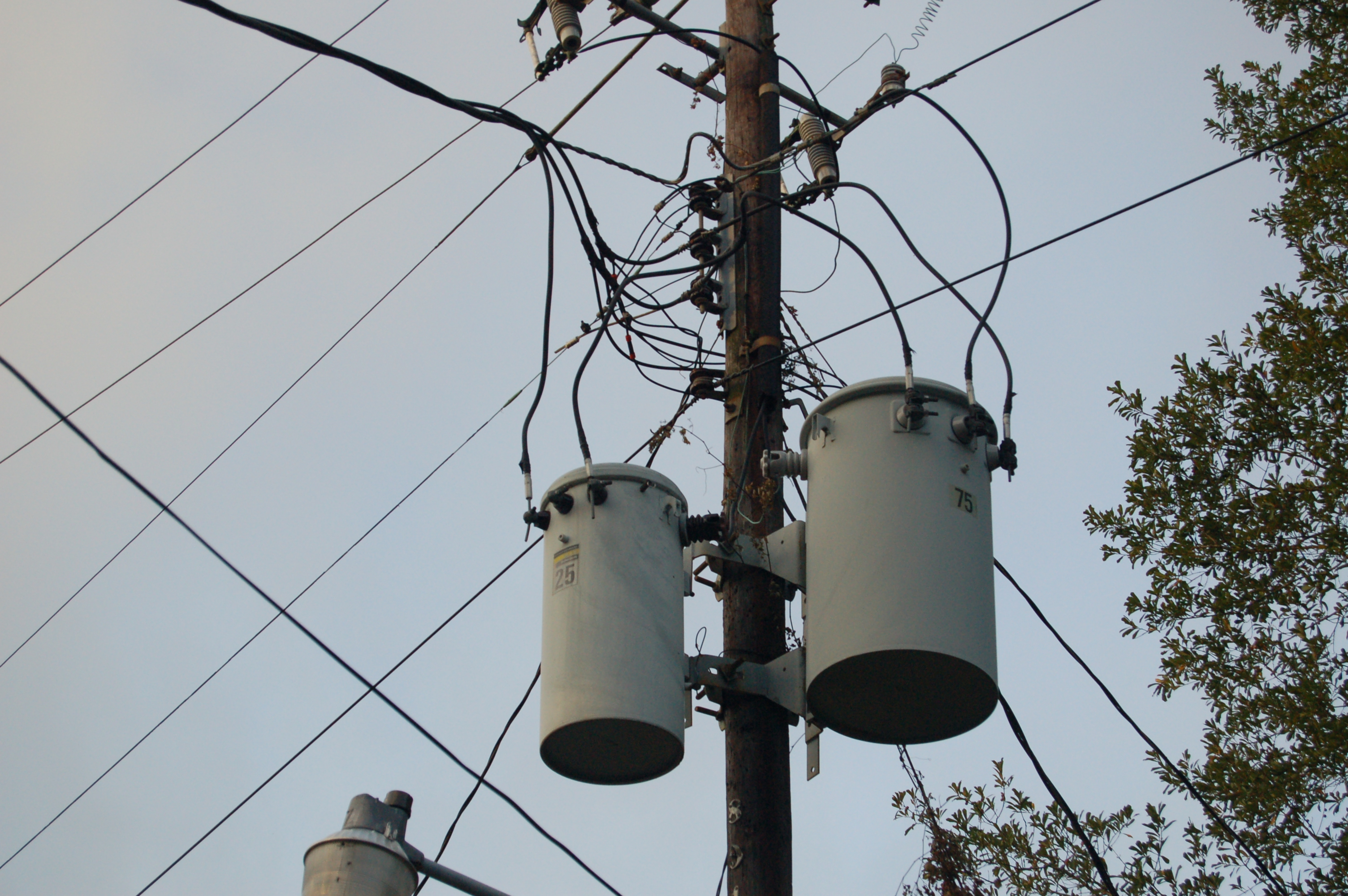

By looking at your pictures it would appear that you have the common style of 120/240/240 delta connected power system.
That is you have the primary power available as the 120/240 volt single phase source being supplied by the big 75 KVA transformer with a second 25 KVA 240 volt transformer supplying one leg of the three phase with the third phase leg being supplied as a 240 volt phantom phase.
This is a very common design for places that have most of their electrical load coming from 120 or 240 volt single phase equipment or other systems and only a limited amount of equipment that needs a full three phase power supply.
