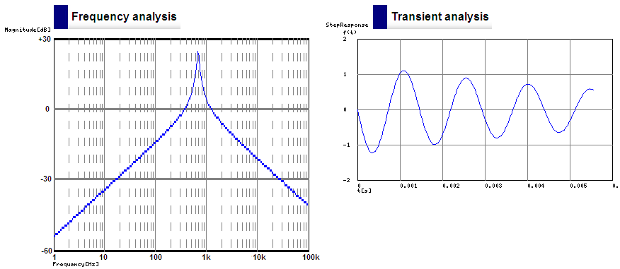

Hi Guys...i am building the circuit that i have supplied a link to but can't find any info about how it works, setting up or testing, so far i have built the input stage and the top filter (u1a and u1b) respectively, on feeding the input with a gorgeous sinewave, everything looks good untill the signal comes out of pin 9 where is is ringing badly? i don't know what to expect at the output, i am assuming that as the frequency changes, the voltage at the output rises and falls respectively as it does on mine, i expected a clean rising and falling D.C voltage at though instead of a peaky waveform at the Cathode of D1 though, can anyone give any insight to this circuit please?
I am aiming to be able to hook up my signal generator and sweep though 40Hz-16Khz and seeing the leds sweep through from bottom to top as the frequency rises.....or am i mistaken about what this circuit does?

The schematic was wrong for many years but has recently been corrected.
It uses obsolete and hard to find ICs. Ordinary ICs will not work unless the circuit is re-designed.

The LM3900 was a very strange amplifier and the only one like it. Today thare are many opamps that can be designed into a similar circuit.
The LM3915 is a standard world-wide LED VU meter for up to 10 LEDs. The Japanese smaller one is (was) very rare.

AudioGuru, did you ever build this circuit? do you know what should be present on the cathode of D1?
No, I don't build crappy old circuits full of errors that use obsolete parts.
I used an online calculator to show its mid-frequency filter response and found another error:
R13, R15 and R17 are listed to be 580k which is not a standard resistor value. Maybe they should be 680k which makes almost the same results.
The mid-frequency filter peaks at 628Hz which is too low for music but OK for telephone quality speech.
Of course the filter rings like a bell as shown in the Step-Response I calculated, its Q is way too high at 15. I think with only 3 filters, they should have a flat response in their bandpass, not a narrow peak.

ok guys, you got me convinced, i'm going to scrap this circuit and find a better one
