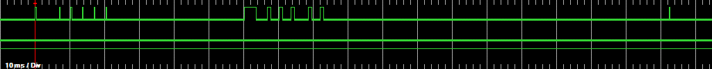

A 3 channel software PWM.
Actually just an up and down loop for somes leds. The pulse time & period are too long for servos if you can see the bitty 10ms/div at the bottom. The analyzer seems pretty sensitive to pin loading? which in turn seems to effect the trigger. This caused the analyzer to lock up repeatedly.
Well I used channel 3 for the trigger. Also using the older style PicKit2 with the black button, so not sure even if these have the pulldowns. The fact that the load was a regular power hungry led "seems" to have been the issue. Tried external pulldowns for channels 1 & 2, but ended up disconnecting them and the leds for the posted screen shot.
