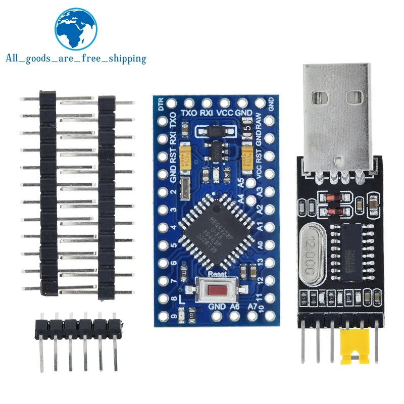

No, as rjenkinsgb said, it doesn't need the 5V - which is why you can program the mini with just an external ground, serial in and serial out (and it's own power of course).

No, the mini - tiny board with no USB chip on-board.

Yes, but it's easier to remove the fuse.
Here's the mini schematic.

For the moment I am using the Arduino uno.
I would like to make sure please that it is possible to do the same for the Arduino Uno?
That is, to cut the 5v line of a USB cable, and while the Arduino uno is powered from an external 5v power,
Then connect the modified USB cable to program the Arduino uno and download data from it?
