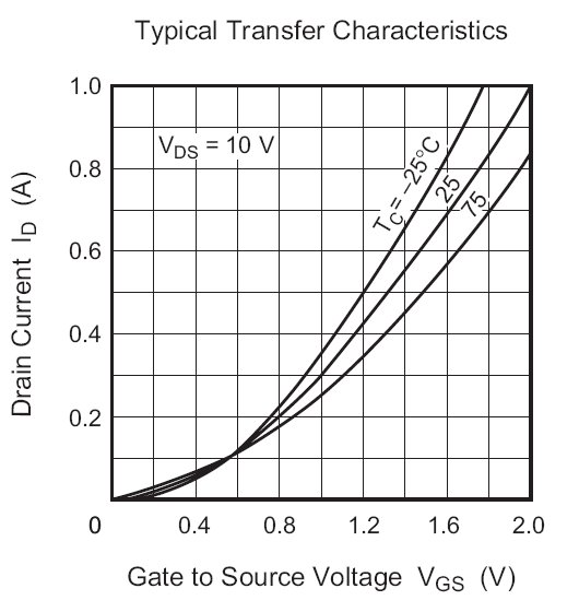

Some of my students purchased the 2SK1058 (n-chan) / 2SJ162 (p-chan) complimentary MOSFETs from Futurlec for an audio amp project. I thought it was weird that the 2SK1058 was a little over a $1, and the compliment 2SJ162 to it was over $7, both from Futurlec. So after they came in, the amplifier did not work, set even to its lowest bias. I personally tested the removed MOSFETs, as well as other spares that were never used. Every single 1058 acted like it was always on, regardless of its Vgs. The 162s acted appropriately for a p-channel MOSFET.
The most basic test consisted of a short between gate and source, a 15 ohm 10W resistor from drain to +10V, and source grounded. The MOSFET acted as if it was on, with a Vds of ~0.7V! I couldn't turn the MOSFET off at all. I checked another five of these and they were all like that.

Thanks for the reply, and I agree with you on the slightly "on" aspect. However, if you looked at what I did, you'd see that they are definitely not just slightly on, but very on. Below is the transfer characteristic of the N-channel 1058 from the data sheet. As you can see, it should have an Id of maybe a few milliamps at Vgs=0. The parts that I tested, including 5 virgin parts that came out of the anti-static packaging, were exhibiting an Id of ~950mA at Vgs=0.
The 2nd graph is one that I did for the P-channel 162. As you can see, it follows the appropriate curve for a P - channel, noting - of course, that the polarities are reversed for everything. It's Id<10mA at Vgs=0.

The datasheet does not have spec's for the max current when the Vgs is zero. Every other manufacturer does.
Two graphs show a typical current of zero when the Vgs is zero.
2SK1058 has the unusual feature of no significant threshold knee.

Naw, but it DOES specify a "Vgs Cutoff Voltage" of 0.15V-0.45V, conditions Ids=100mA Vds=10V. So below that Vgs, current must be below 100mA. Which it is definitely not.
