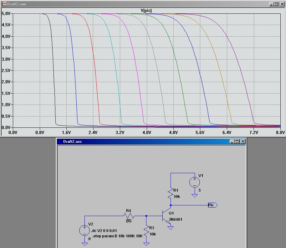

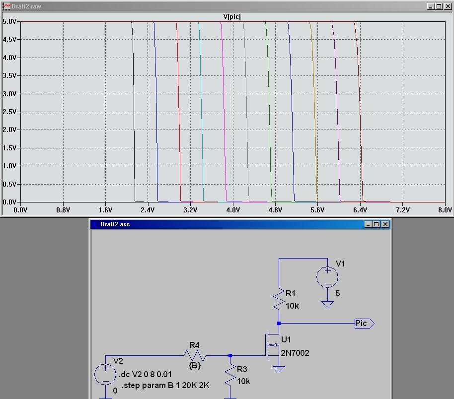

Here is input buffer with a variable trip point. The plots are for a values of B from 0 to 20KΩ in steps of 2KΩ. With B=0, the threshold of the NFet determines the turn on voltage.
Using a 2N4401. Now B = 10KΩ, 20KΩ, 30KΩ,...
Thanks Mike. That's thorough, what program is that?
I took another look at the 2N4401 I used before. The circuit was as shown below. The only difference between your diagram is that I didn't have a pull-down on the base, which I should add. Remember though, that this didn't work for me either. I prefer to use the 2N4401 over the mosfet as it isn't as sensitive.
