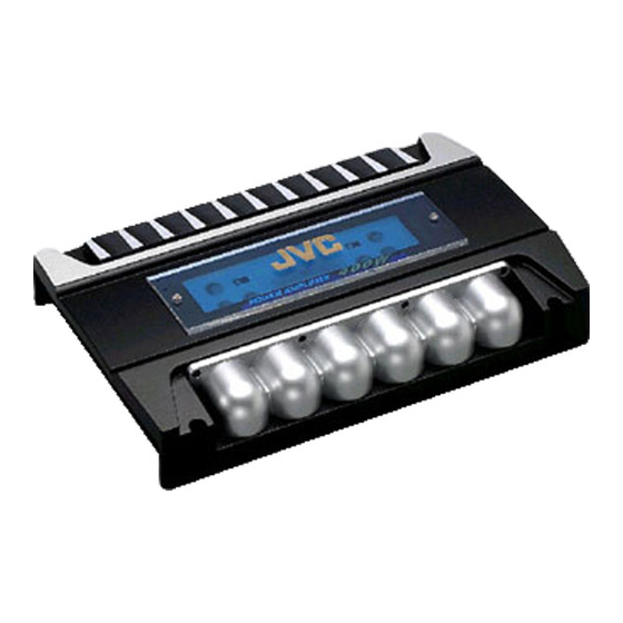

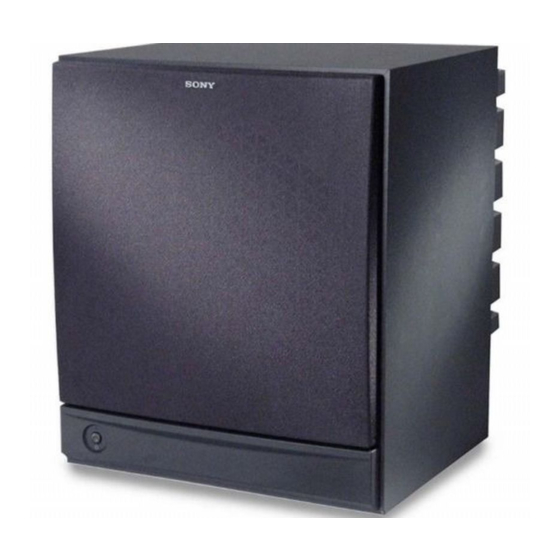

Quick side note... I have a couple possible options for a sub until I ressurect Hamboo...
I have this amp and a 12 inch passive kicker that will handle anything I've got.. I also have a 400 watt JVC car amp (which I almost got running before I shorted the power supply) and a 2000 watt active loud speaker. would it be unrealistic to take the lowpass filter/crossover from the sony amp and wire it to the edison 2000watt amp, and rewire that to the kicker?
