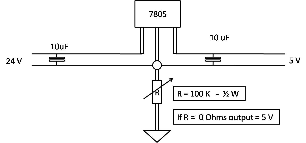

Use 7805 Voltage regulator IC
By changing the Resistance R you can vary the output from 5 V to 24 V.
if you don't want to Vary the Out put Then shot the Center Pin to the Ground.
1 Amp is the maximum for this IC

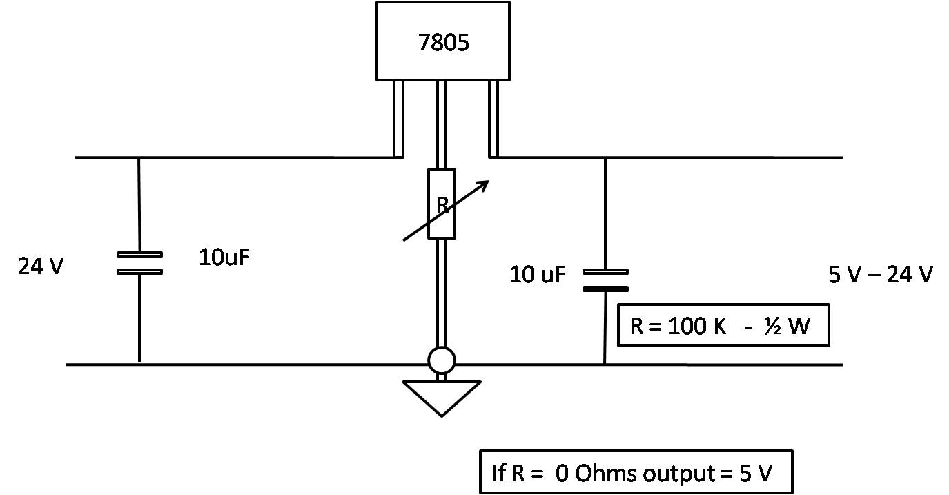

I would suggest that you check the circuit drawing you have posted.:)
Here is a small correction in the above Circuit
Thank You Eric , I didnot Notice it....
10 Uf capacitors are not mandatory, it is a good practice to put , it will avoide spikes....
As with any linear regulator, make sure you heatsink the regulator to dissipate the heat generated from the regulator voltage drop: (Vin - Vout) x current.

That is a particularly poor way to jack up the output of an LM7805. The current that flows out of the GND pin is a stong function of temperature, the input voltage, the phase of the moon, etc.
The better way is to use a LM317 with a voltage divider (two resistors) to set the output voltage. If you have to use 7805, then the voltage divider upper resistor must be like 100Ω so that the current out of the GND pin is a small fraction of the total current that flows down the divider...

But let me ask you one thing, What is the current requirement Here ?

The circuit is bad no matter what the current requirement. The OP hasn't responded to the question regarding current, nor to the ambiguous voltage.
You should not ever simply put a pot in series with the common lead of a 7805. It will regulate poorly if at all, and may be unstable. The performance will vary widely from lot to lot and amongst manufacturers.
As MikeMl said, the best approach is to use a properly designed circuit using an adjustable regulator. My preference is to use a fixed regulator for the voltage that's intended.
I used to it, I made it and it is working very well, all the regulator has its own ranges at least .1 V variation if you spend Dollars on that... But this circuit cost Rs 10/- Only up to 1 Amp it will work well, with 24 V input, Test it , try for a 10 Ohm resistor 1 W or 1/2 W, The Heat it produces....etc etc If the Amp is less the Heat it produces will be less, Don't You Understand mneary
More over the resistor is connected to ground, it will not produce much random voltages or noise to it.......!
7805 quiescent current can vary by 8% with load changes and 13% with input voltage changes. A single resistor in series with the common line of a 7805 may be stable if the input never changes and the load is constant.
A properly designed circuit will always work.

I have to agree that putting a resistor in series with the GND terminal of a 7805 or similar regulator is not a good idea unless you can tolerate a wider than usual regulation range. In particular, i would think a 100k resistor would have to be very very bad. There are a number of reasons why this isnt a good idea.
Yes, it "works", but what else it does is makes the regulation worse than with just a plain 7805 with no resistor, and it can be very much worse as the other posts alluded to. I guess if this isnt a problem because the application can tolerate the larger voltage swing then that's fine, but i myself dont like cutting corners in this way. I would rather use an LM317 too.
There's only one application i can think of that benefits from a resistor in the ground lead, and that is when you want to make sure that one regulator is slightly higher than the other by a very small amount, and in that case the resistor is made quite small like 10 ohms. A small resistor boosts the voltage by a small percentage and so the regulation stays almost the same as a bare 7805.
