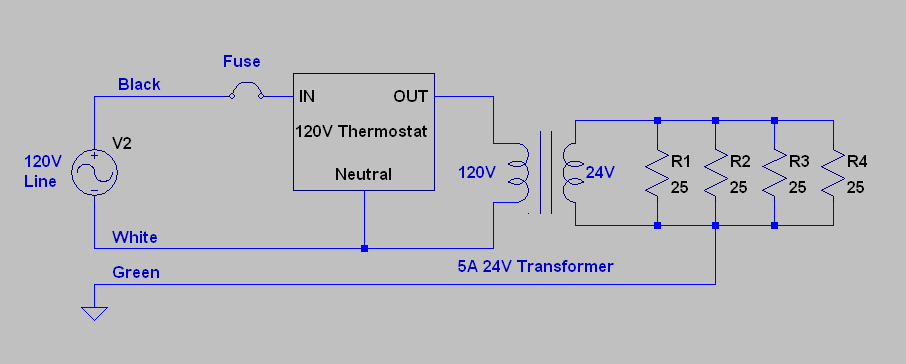

I am undertaking my first project since 2004 and even then my skill was minuscule. I have what "I think" will work and I would appreciate your guidance in arranging the components correctly.
I will mount 4 24VAC/36VAC Compact Power Transformers to an aluminum enclosure. I will provide the power for each transformer through a lug strip and ground to the aluminum chassis and ground that to the 120v ac plug. I will then use 4 insulated fuse holders with 1.25 amp fuses to power each resistor (that I have yet to figure out how to suspend). I will then use a common ground for the opposing resistor leads. Please don't bash me for my ignorance I know for most it is a very simple project.
The resistors will be mounted in a small metal box inside a 4ft x 4ft x 18in three quarter inch plywood box with two 12v fans (I already have the power source for them) constantly recirculating the air over the resistors to heat the enclosure. I am slowly working on a sketch I will post as soon as I finish.

Why does each resistor need its own fuse? I would put just a single fuse in the transformer primary. I see that you are still bound and determined to start a fire...:D
I tend to over fuse to avoid fires ironically! LOL I will be able to put an exaust fan and introduce more fresh air with the more powerful heating elements. Could you please explain what you mean by putting a single fuse in the transformer primary?

I suggest that you get a normally-closed thermostat set to ~100degF and put that in series with your resistor(s).
The goal of fusing is to prevent a fire anywhere, including in the transformer. Wire a slo-blow fuse in series with the transformer primary. Start out with a 15A fuse. Get your project running, and measure the AC current flowing through the fuse into the transformer primary. Now replace the 15A with a fuse that is about 25% bigger than what you measured. If a short occurs on the transformer secondary side, the increase in primary current will blow the fuse. If the transformer develops an internal short, the increase in primary current will blow the fuse...
The whole reason for using a transformer in a project like this is to provide isolation between the AC line and the heater side and to reduce the voltage on the load side to minimize shock hazard. As you have drawn it, you have the load side connected to the line side, so why bother with the transformer(s)?
If you dont care about shock hazard, then do what the previous poster suggested; namely eliminate the transformers, and connect the resistors in series, and power them directly from the 120VAC line.
Why don't you just discard the resistors, and wire up a single 120V lamp socket. Then everything is insulated, and you can pick an appropriate Wattage to heat your box by just screwing in a different lamp; anywhere from 10W to 150W.

Ok I thought I needed the trans formers to lower the voltage. but if I can run the resistors straight off the 120v I will. I like the resistors because its new to me and I like the idea of never changing a bulb and reliable heat. Oh well I thought I had figured something out on my own. Ego check #3 today.

If you want to use the transformer for safety, then here is my recommendation:

Thank you. I Like! I agree the lightbulb is cheaper but using resistors for a heat source is new to me and gives me something to do while bored at work. Where do you go to build the circuts like that?
Mike can you please show me how to make it work with these trans formers I can't beat the price. https://www.goldmine-elec-products.com/prodinfo.asp?number=G12951
Use two of them. Dont hook up the 36V winding. Use two resistors in parallel per transformer. I still think that you do not need all four resistors, so start with one transformer, and one or two resistors.
