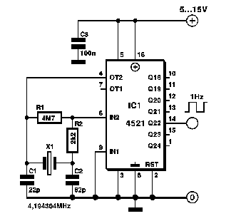

I have a rough idea of how to make it but I'm having trouble with the multiplexing of the displays as I would like this clock to be portable and run on batteries. I was thinking of making this circuit for the 1Hz clock pulse signal as I want it to be fairly accurate: https://en.wikibooks.org/wiki/Practical_Electronics/Plugins/1Hz_Oscillator

Even if you want to use obsolete logic, your 1Hz clock is still too complicated - you only need one IC!.
1-hz-png.10810
Thanks Hero999 for the diagram.

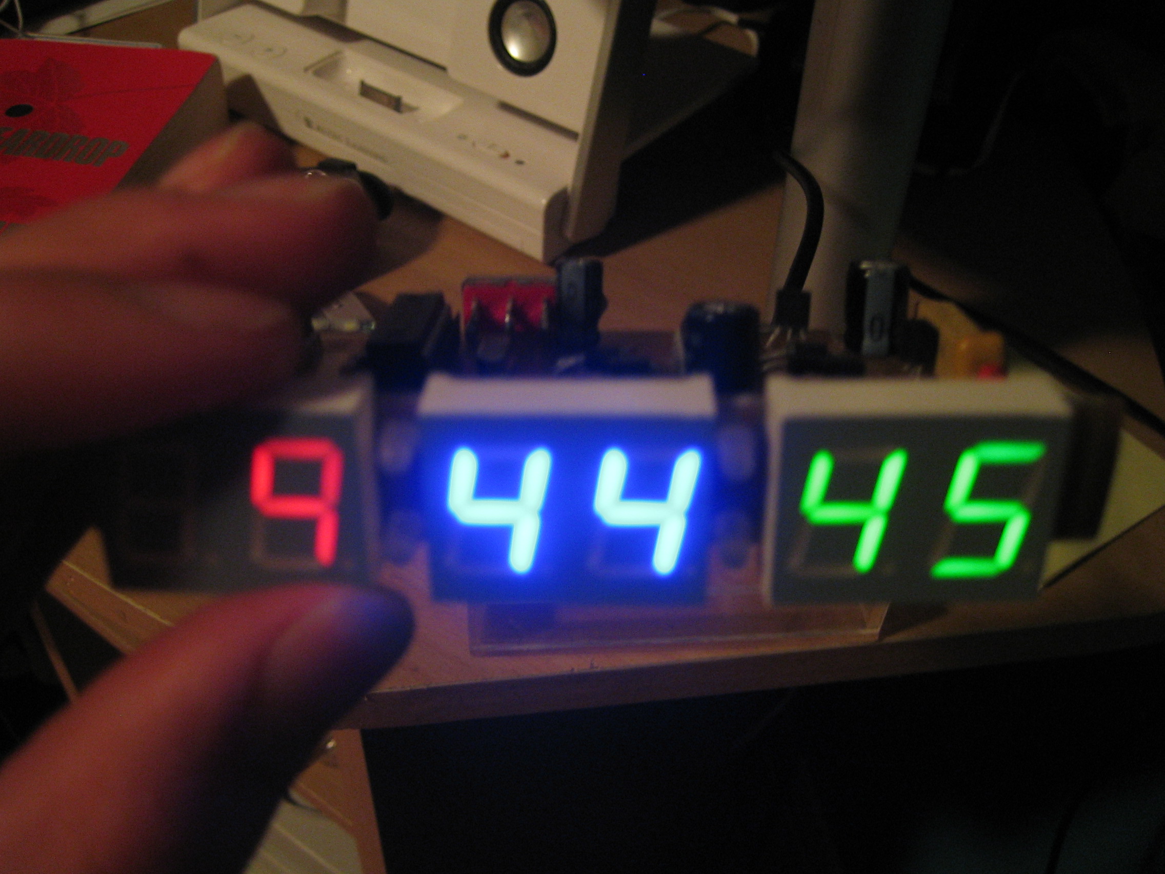

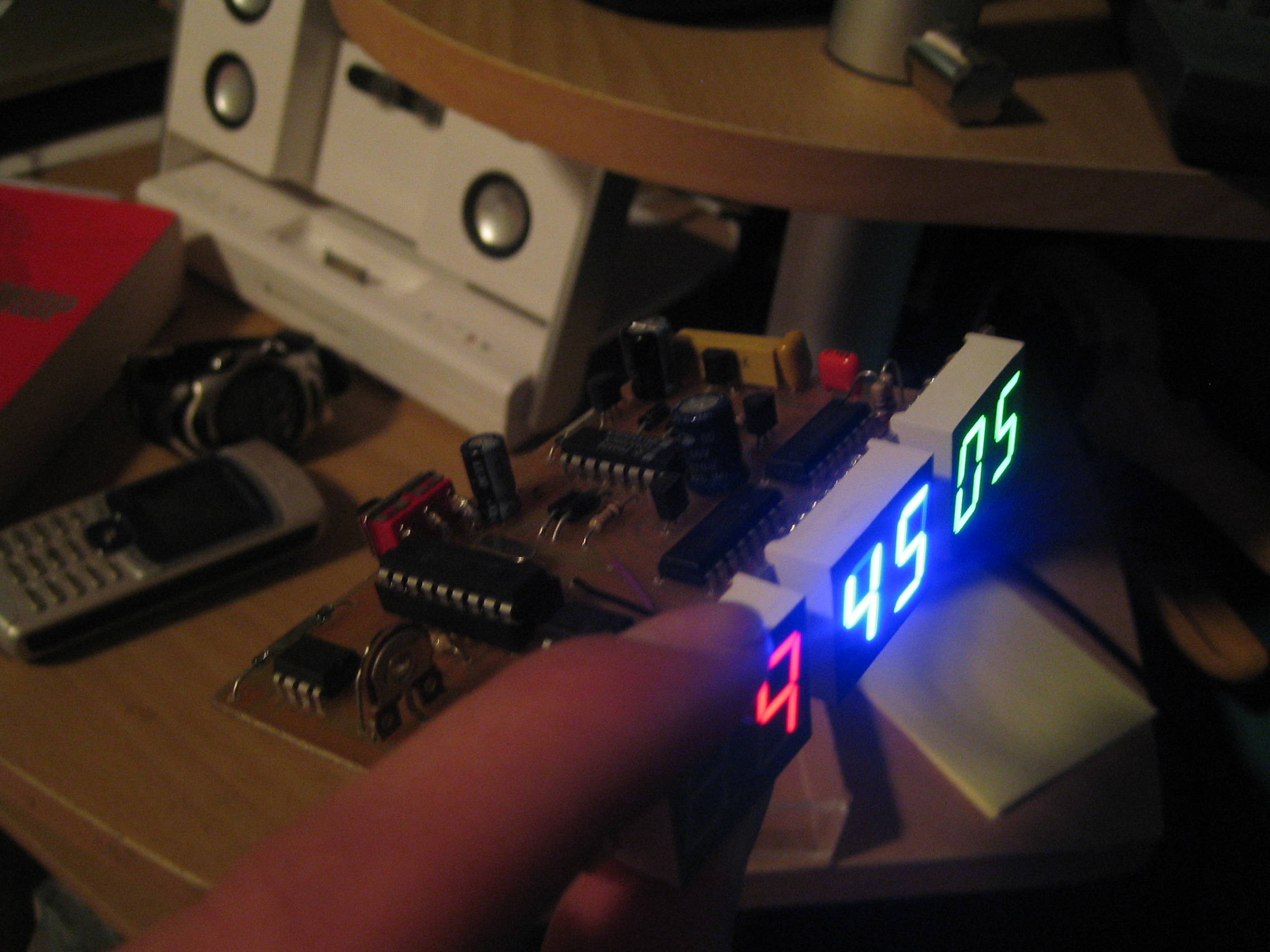

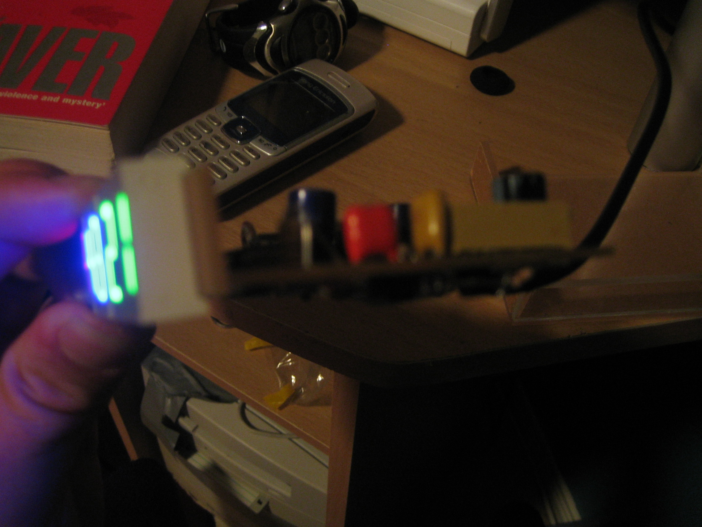

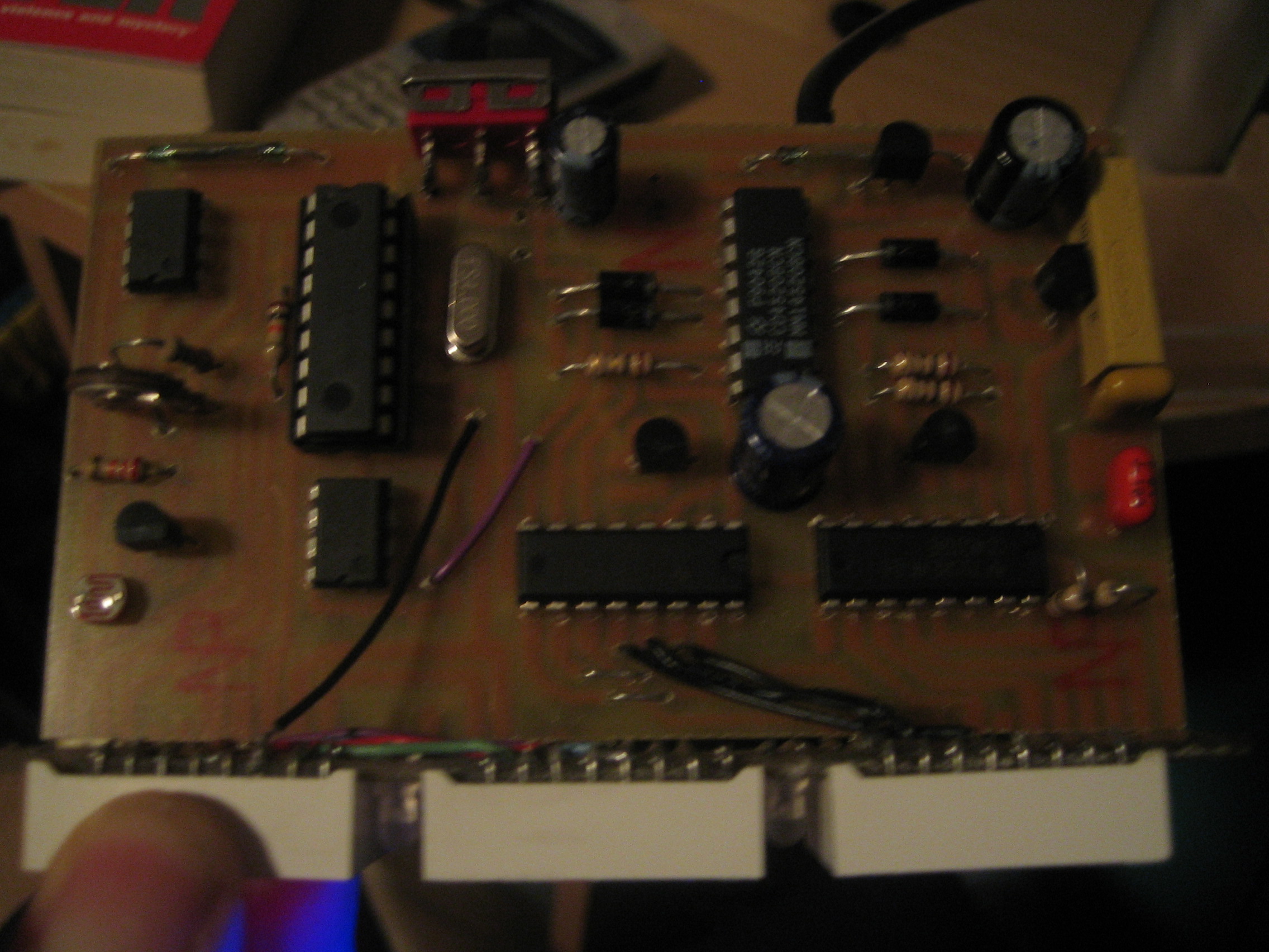

Here are some pics of my clock, some of you may remember me talking about it earlier this year, well, here it is..

I like retro digital clocks :)
Very nice Mike, I like you vertical standof segments idea. Cheers for the pics.

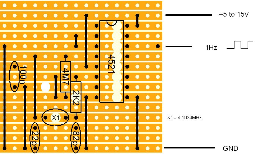

Edit:Today I built the signal pulse circuit on veroboard and it is dead accurate, very pleased with it. The display I have is 4 segement common anode display all in one and silly me only realised when I was trying to get a 1 second counter working that the 4511 is a common cathode driver.
