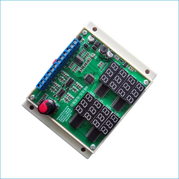

Hello, has anyone seen a 24 Vdc input to a variable 0-10 Vdc output converter? Maybe something that could be DIN rail mounted if it exists.
danadak
Active Member
0 - 10 V how much current ?
How do you want control, pot or button entry or rotary encoder ?
Current limit set ?
Regards, Dana.
