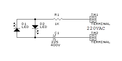

You can use a capacitor instead of resistor to drop the voltage. There is no power dissipation there.
Below is a schemtic that illustrates it. I used two LED's to remove the DC in the capacitor. The 1K resistor is there to limit any surge current when you turn ON the switch. Most of the voltage drop will be in the capacitor.
Bear in mind, that if you are only using one LED, the other LED in the diagram will have to be replaced by a regular power diode (1N4004 or similar).

i'll try above schematic.but what shld be the rating(wattage) of 1K resistor? and cap is 225,400v.is it 225uf 400v?
please clarify

If you have to ask you SERIOUSLY! shouldn't be attempting to build it!. You are aware that this will make your entire circuit live to the mains?, including the LED itself!.
The circuit shows the capacitor as a 225uF electrolytic - which looks completely (and dangerously!) wrong - a 1/1000th of that, and non-electrolytic, would be more like it?. Not that I'm suggesting that would be the correct value!.
Seriously, use a wallwart, and feed low voltage to the LED, don't run it off live mains!.

A 225uF capacitor will make a very loud BANG in that circuit.
No, the resistor would smoke badly just before the LED burned out.
motion said:
FYI, 225 is a 2.2uF capacitor. It has to a high voltage capacitor though.
I know how to read capacitors thank you, but you DON'T label it like that on a circuit diagram! - some small capacitors are marked using that method (but it would be unusual to find a 2.2uF so marked?). Your diagram clearly marked the capacitor as 225uF, and even showed it as an electrolytic! - if you're commonly labelling your diagrams like that you're going to cause massive confusion!.
