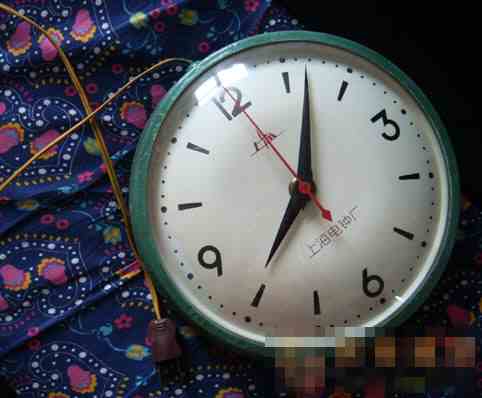

The early "electronic clocks" was fixed cycle alternating current (50 & 60Hz) driven, 60Hz circuit is simpler than 50Hz circuit.
Of course there are exceptions, it's the same with some digital clocks too and it's not much of a problem if the user is aware that it's running fast or slow, but the vast majority of appliances don't use clocks synchronised to the mains so it isn't an issue.
