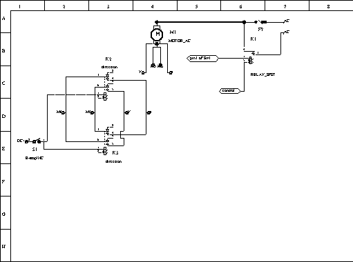

Now I just have to come up with a switch that will take 3x3 wires as seen on the motor diagram to allow power one way and then to switch the two wires only for reverse polarity. Kindof hard to explain without looking at the wiring diagram if you follow.
That's the EZ part, the safety part is a bit messier. If I get time , I'll shoot ya 1
edit to add: Damn conversion proggie threw out my remarks, which were: M5 and M6 are those numbered terminals on the motor and the X and Y are the wires that went to the terminals , in other words disconnect the wire from term 5 on the motor that wire becomes x, disconnect the wire that went to term 6 that wire becomes Y. The relays K2 and K3 control direction, the relay K1 is the engage relay. Clear at all? limit switch stuff later.

thanks buddy, I tried taking a closer look to get a better idea of what you mean but the picture is quite distorted when blown up. Is there any way you could send me a bigger picture? Also there is a total of 6 wires with #5, #8 which switch back and forth. Thanks again!

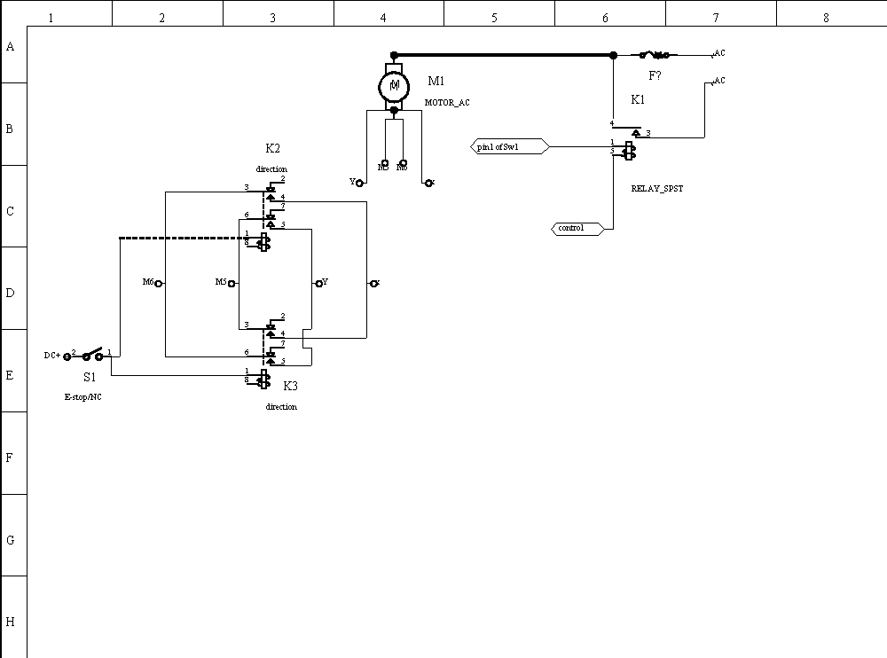

I see it's just wires and not terminals. connect wires 1 & 3 together and add another wire that goes to x on the board. Connect 2 & 4 together add a wire that goes to Y on the board . You can see where they go in the drawing. Now attach wires comming fron the relays--- M5 to wire 5 from the motor, attach M6 to the wire 6 (is that a 6 or an eight?? ) from the motor. The relays can be had at Radio Shack for <$8.00 , thier Potter Brumfeild. # 275-288 https://www.radioshack.com/category.asp?catalog_name=CTLG&category_name=CTLG_011_002_013_000&Page=1

I am wondering, is the number of relay 275-288? and not 218? For some reason its a 8 and not a 6 on the motor wiring diagram. But I understand either way. I am not too advanced in electronics so I have to look over your diagram in more detail but what you have given me helps!
My original plan was to have the main wires that dont change wired directly to the board in line and the ones that chance on a relay some how. I think your idea incorporates this.

Yes, the relay # is correct. all the high side stuff is isolated , the control is 12VDC.
